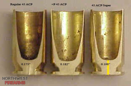

45 Super is essentially a hot/higher pressure 45 ACP with spec brass?
Joe
Yes - with stronger brass.
