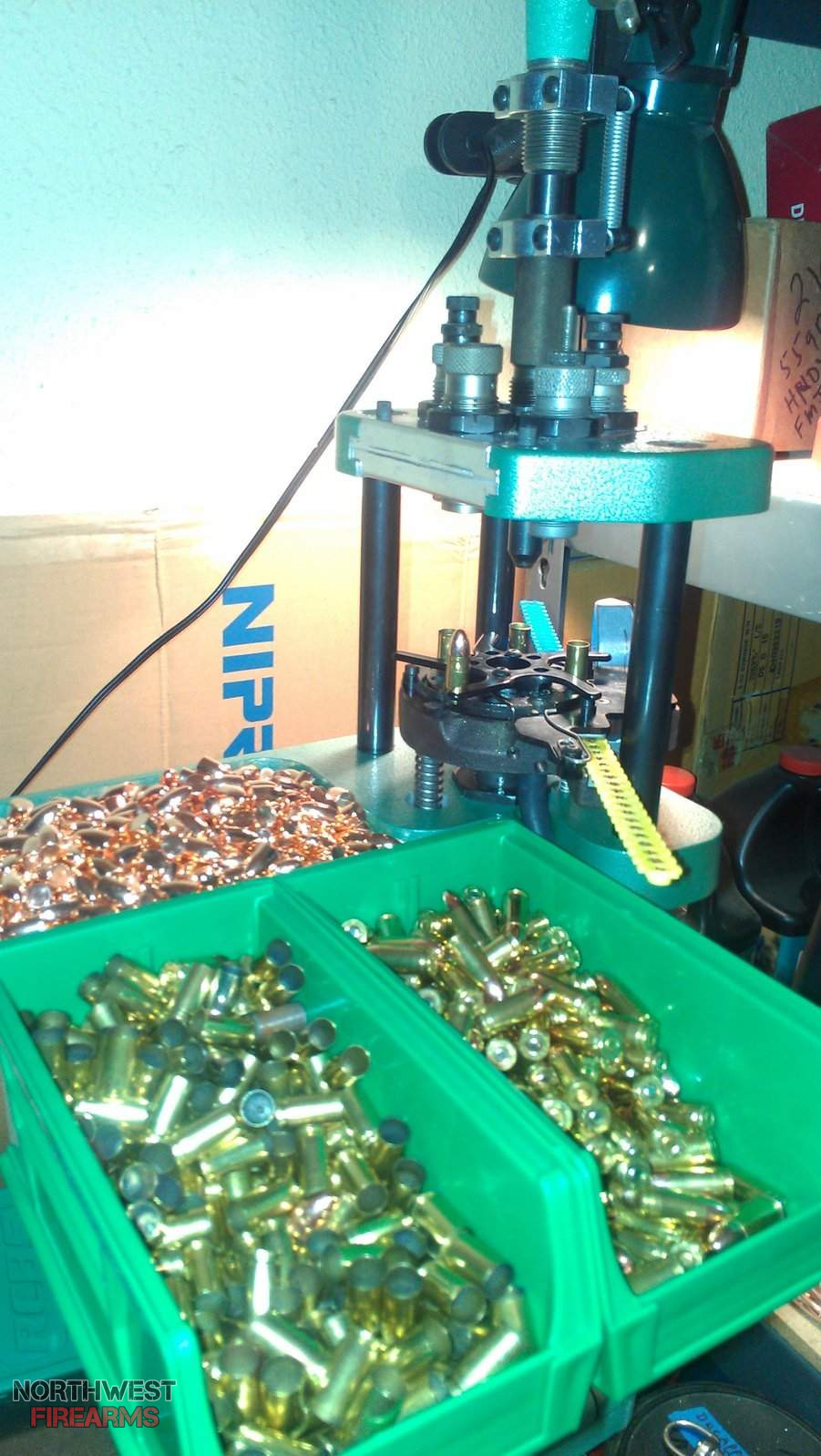

Upgrade your rock chucked to a progressive with their piggyback system. And you can remove it if needed and single stage your big rifle calibers.
