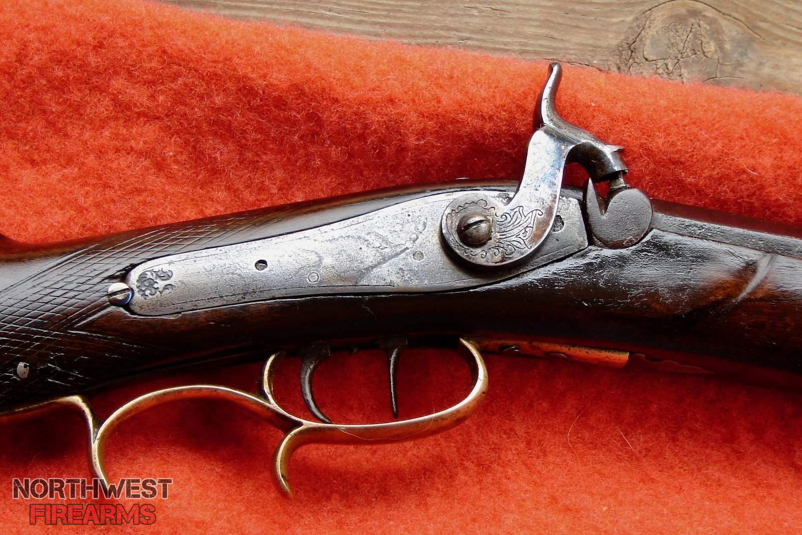

Here is a double set trigger on a St. Louis made "Plains Rifle" circa 1850.
If you shoot the rifle with the front trigger unset , the trigger pull is a few pounds...if you first set the trigger , by pulling the rear trigger first , then the trigger pull is about half of that...
All in all , they can be smooth and crisp enough to rival a modern trigger.

Well now you're making me jealous.
