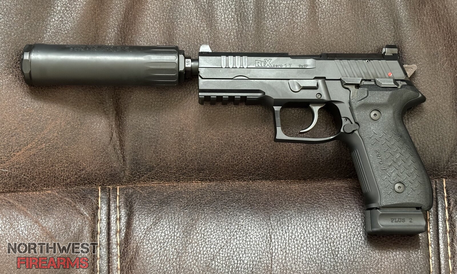

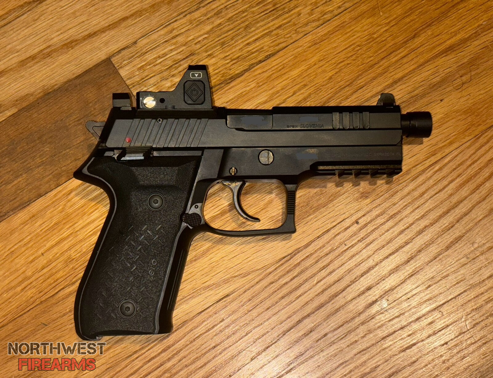

IMO the best value out there right now. Arex zero 1 tactical, optic ready threaded barrel 9mm. $529 (without red dot) at cheap gun club. I love this gun. Accuracy shooting fast is awesome and can use it single action only/cocked and locked (has separate decocker and safety).
Mud test compared to sig p226 (arex was better). In another video he also did 1000 rounds non stop except for mag changes and no malfunctions.
View: https://youtu.be/LuPOqDlaX6U?si=6XduVEJv09y_w9Sz
View: https://youtu.be/Lh8NNOdjILs?si=snGh3tKsG_JovY6d
