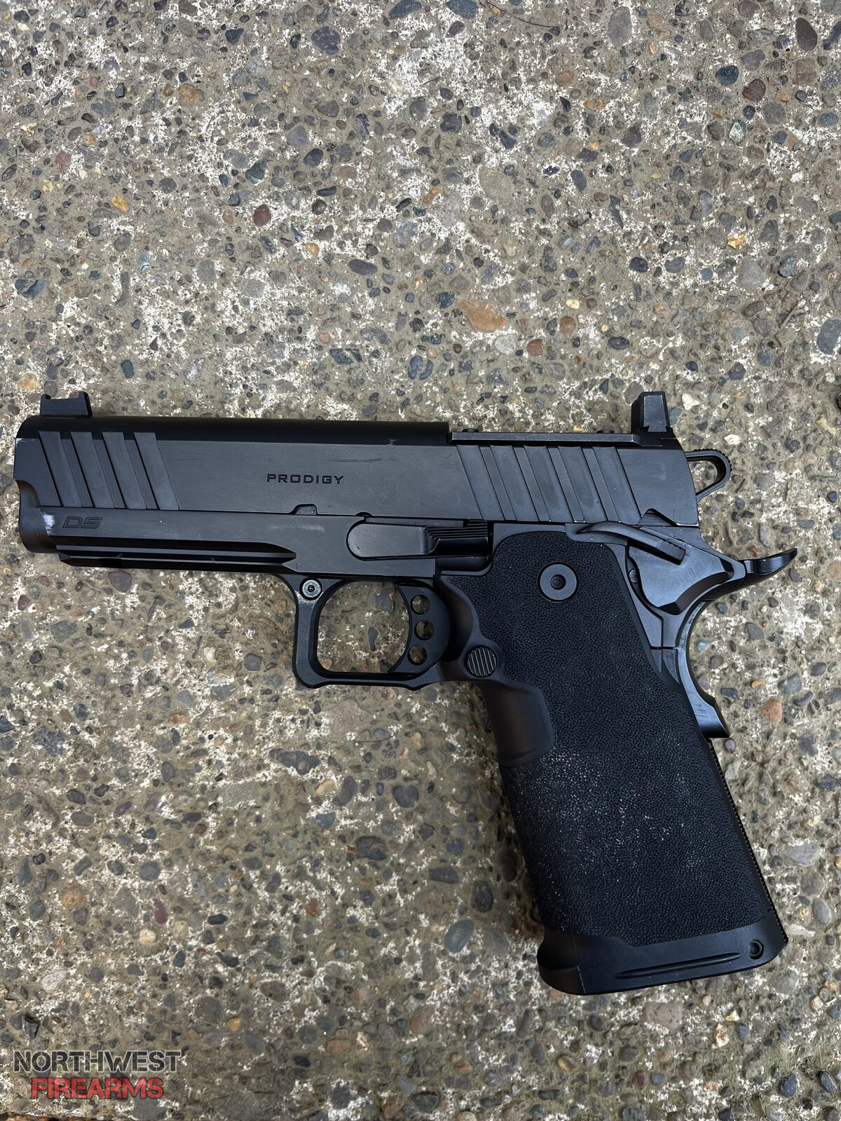

So, I got the gun for significantly less than retail, but brand new. I have a post explaining how to do that. You can search it on the forum. Upon getting the gun, I got home and couldn't leave it alone. I spent hours "playing" with it. Racking the slide, dry firing, cleaning, lubing, etc…
-The grip texture is fantastic, in my opinion. If you have a Hellcat, I believe it is very similar to that.
-The finish on the gun is nice. Granted, it is cerakote and not DLC, hence the price point, but I find it ok. So far, 750+ rounds in, holstering and unholstering, I can't see any bad scratches or wear on it.
-The sights are great. I'm suspicious to talk about them because I love the blacked out rear/fiber optic front. I have it in most of my guns.
-All controls work just fine. The only thing that is not optimal is the slide release. I have average sized hands and can't get to it to send the slide home on reloads.

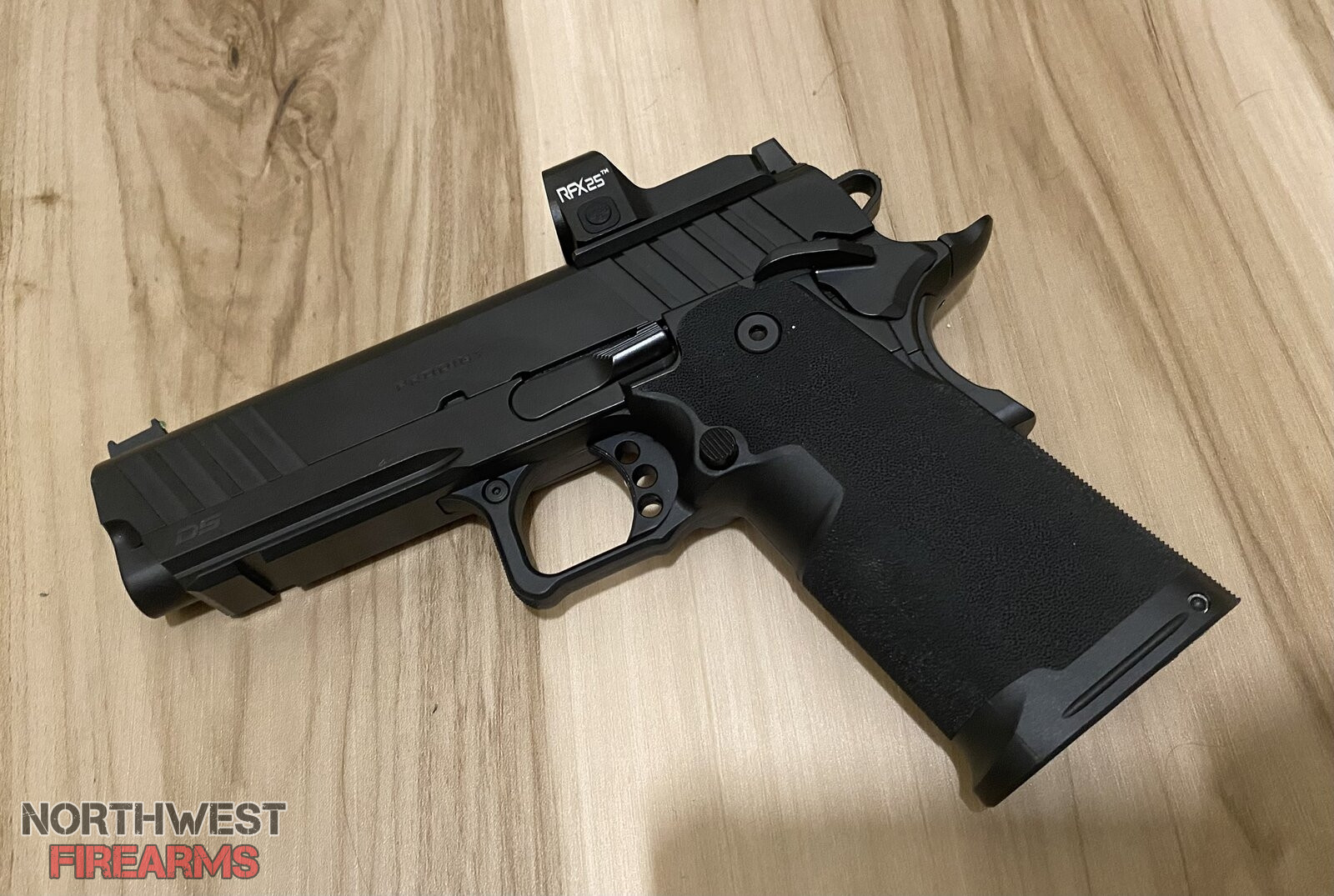

This was one of the dots that fit the plate that comes with the gun and I decided to give it a try.
Gun ran fine but It could be upgraded. I usually film myself shooting so I can see the gun from a "third person" perspective. I noticed it nose diving when returning to battery and decided to install a lighter recoil spring. Stock is a 12lbs if I'm not wrong. I went with 10lbs.
I also decided to put a 17lbs hammer spring. I believe stock is 19lbs.
When changing the recoil spring and after many times field stripping it several times I was also done with the 2-piece guide rod so I replaced it with an Atlas Toolless guide rod. What a difference!

- The rails have a thick layer of cerakote that makes it a little rough at the beginning.
- The disconnector drags on the slide (or vice versa) really bad, to the point that many times it would cause the slide to be held in the "locked" position even without the slide lock/release engaged.
- The trigger was HEAVY and didn't feel good. It was close to 6lbs and the reset was quite long.
So those are issues I identified before firing the gun, and decided to "fix" them before heading to the range and my fixes were:
- The cerakote wears off as you play with the gun, dry firing and racking the slide and I could notice it getting smoother and smoother every time I cleaned the gunk from cerakote and lubed it again.
- I disassembled the gun and dragged the disconnector on a 800-1000 grit sand paper, following the shape of the disconnector head, testing it every few passes until the slide hang was almost gone. After that I oiled the disconnector head and racked the slide a few more times and done. Smooth AF
- I tuned the sear spring. Took me 30 minutes and a few tries that caused some hammer follow or dead trigger until I achieved a clean, crisp and consistent 2.85lbs pull. As for the reset, I tightened the set screw on the trigger until I couldn't fire the gun, then I backed it out about 1/4 of a turn or a bit more and now the reset is short enough for my liking.
