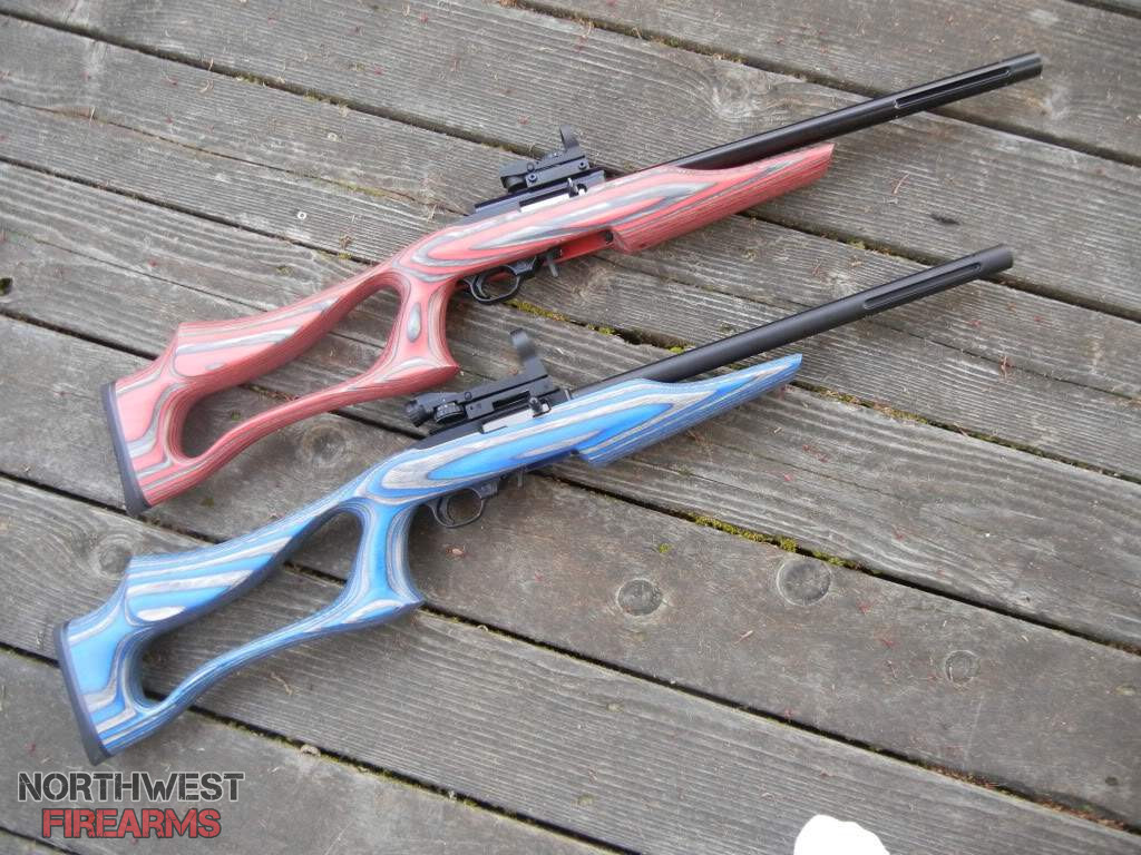

I built a couple 10/22 for shooting Speed steel. I use both the BX-25 and the Alangator trimags (alangator.com/). They both can be pretty reliable however have noticed that both can be loaded in a way that jams a round. I have not done it but my junior shooter and my sone-in-law have both done it. When the mags are loaded to the maximum, the top round does not sit up properly so when the bolt comes forward the bullet jams into the front of the mag. Best I can conclude is that these 2 new shooters don't load the mag properly. Maybe don't push a round all the way in and load another on top of it. If anyone knows what causes this please explain.

Fully loading rimfire mags is a known possible issue.. just leave the 1 or 2 rds short of full and get back to us
