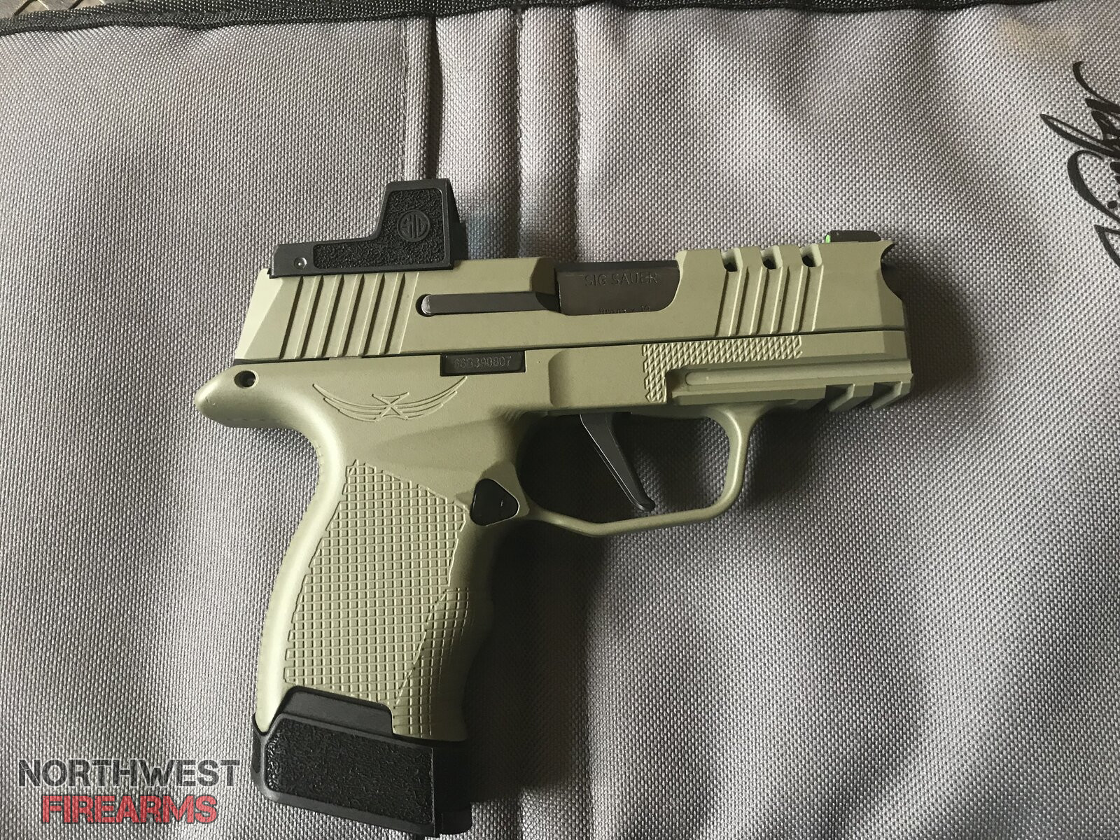

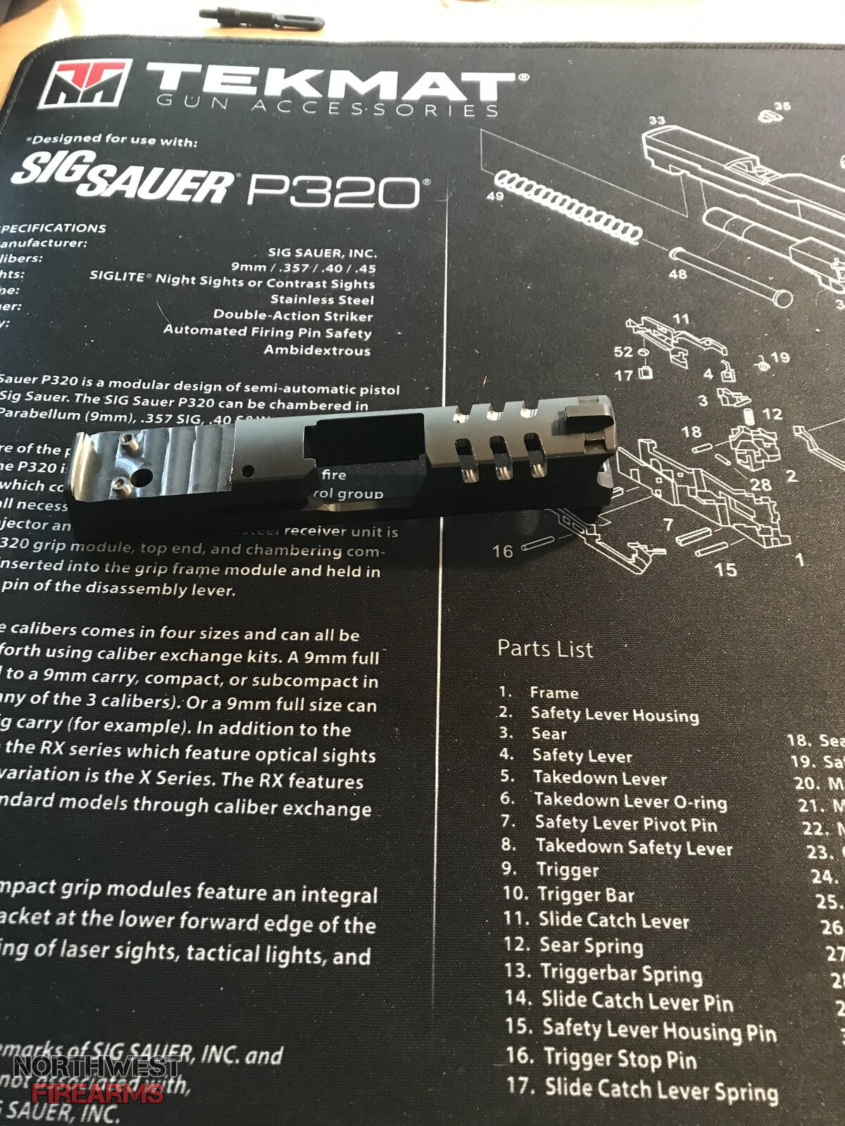

I like the 365 with the xl grip seems to fit the hand better. I do have a 365 grip I keep just in case I'm going to California and 1 10 mag to go with it. I machined a 365 slide to mount a Romeo zero on it. If you decide to go with the 365 slide I have a couple and would make you a good deal.
View attachment 1029809 View attachment 1029811
Thanks, I'll consider it. What do you think of the aluminum frame over the polymer? Any issues with the grip on a hot day?
