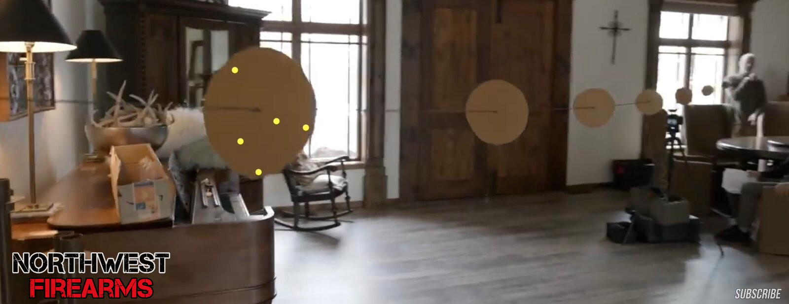

If you hit what you are aiming at, and you know your shotguns pattern, imo you don't have to worry as much about overpenetration. IMO for shotguns, missing the target with 1 or more pellets is where the penetration of unintended targets is most likely to happen. Fe, a hypothetical indoor 5 pellet .410 shot shown below. Whereas if you are on target and you have the right load for the range you are shooting at, overpenetration through and beyond the target you intended to hit is much less of a concern.
