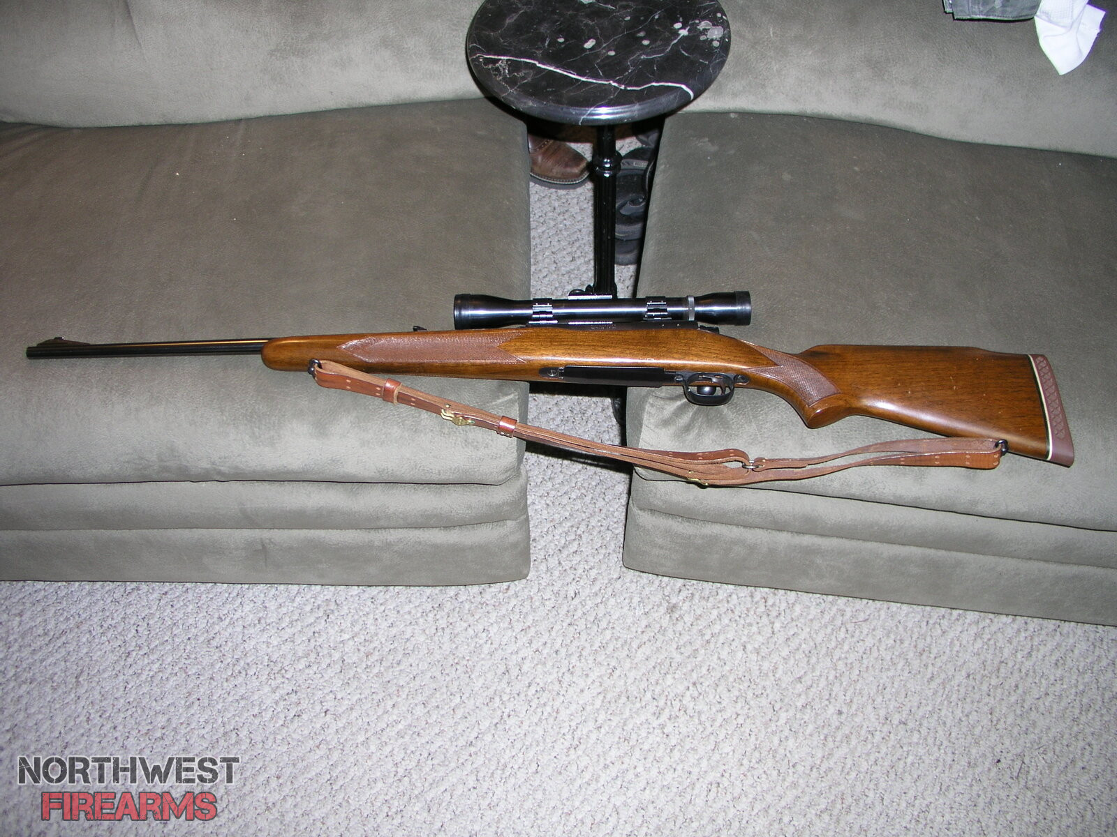

The mount I thought was cool was the "tip-off" style I had on a Pre-64 Featherweight. the gun had barrel mounted sights, like rifles use to, and you could flip the scope over to the left, getting it out of the way quickly in order to use the iron sights. Gimmick or gun gadget is a good term. At least it wasn't as tall as those "see thru" rings I've seen on other rifles.
Not a very good pic, but the only one I have of that rifle.
Hey @Salps ! You have any better pictures of that nice Winchester?
