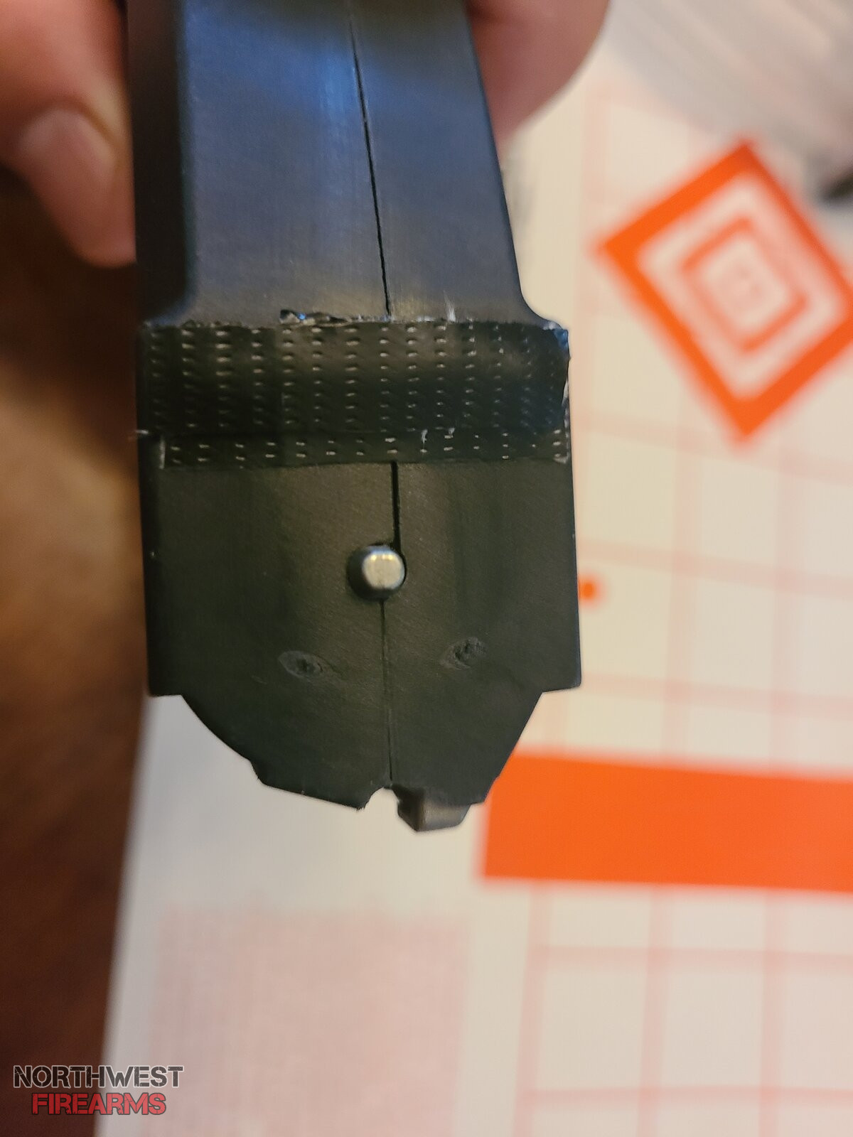

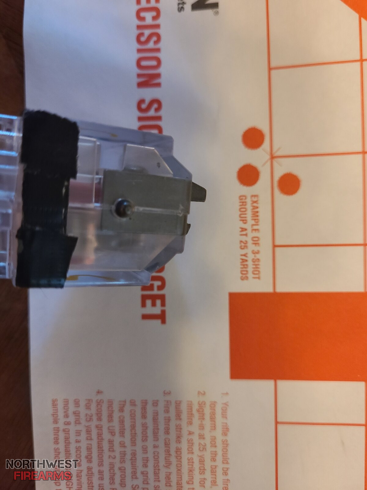

I have 8 or 9 of the bx-25 mags they all jam, I did the. 22 short case trick and they still jam,saw another trick were you build up the back of the mag to eliminate the back and forth wobble, tried it on 4 mags to ruger and two butlercreek mags and they all ran great. Used two layers of gorilla tape 3/8" wide across the bottom.

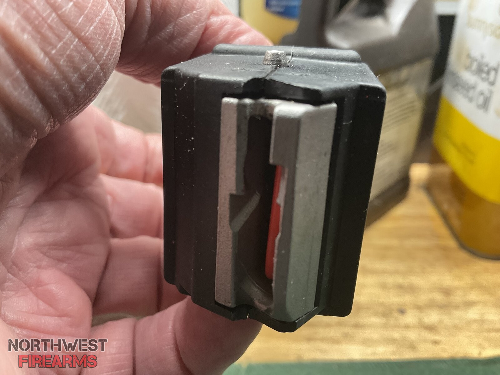

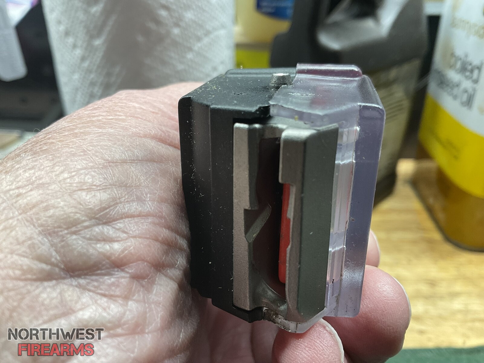

Thanks for your post. Prepping to add the tape to cure my jamming, I noticed a difference between the opaque bx25 and the clear bx25: the ridge on the clear side was raised on all 4 of my clear samples while the opaque ridges aligned perfectly. All 8 were standard Ruger mags. See photos.
Inserted, the clear mags had no wiggle forward or back. Very tight. I remember several jammed every 3-5 rounds.
Inserted, the opaque mags had wiggle, but I do not remember the one I used was jammimg.
