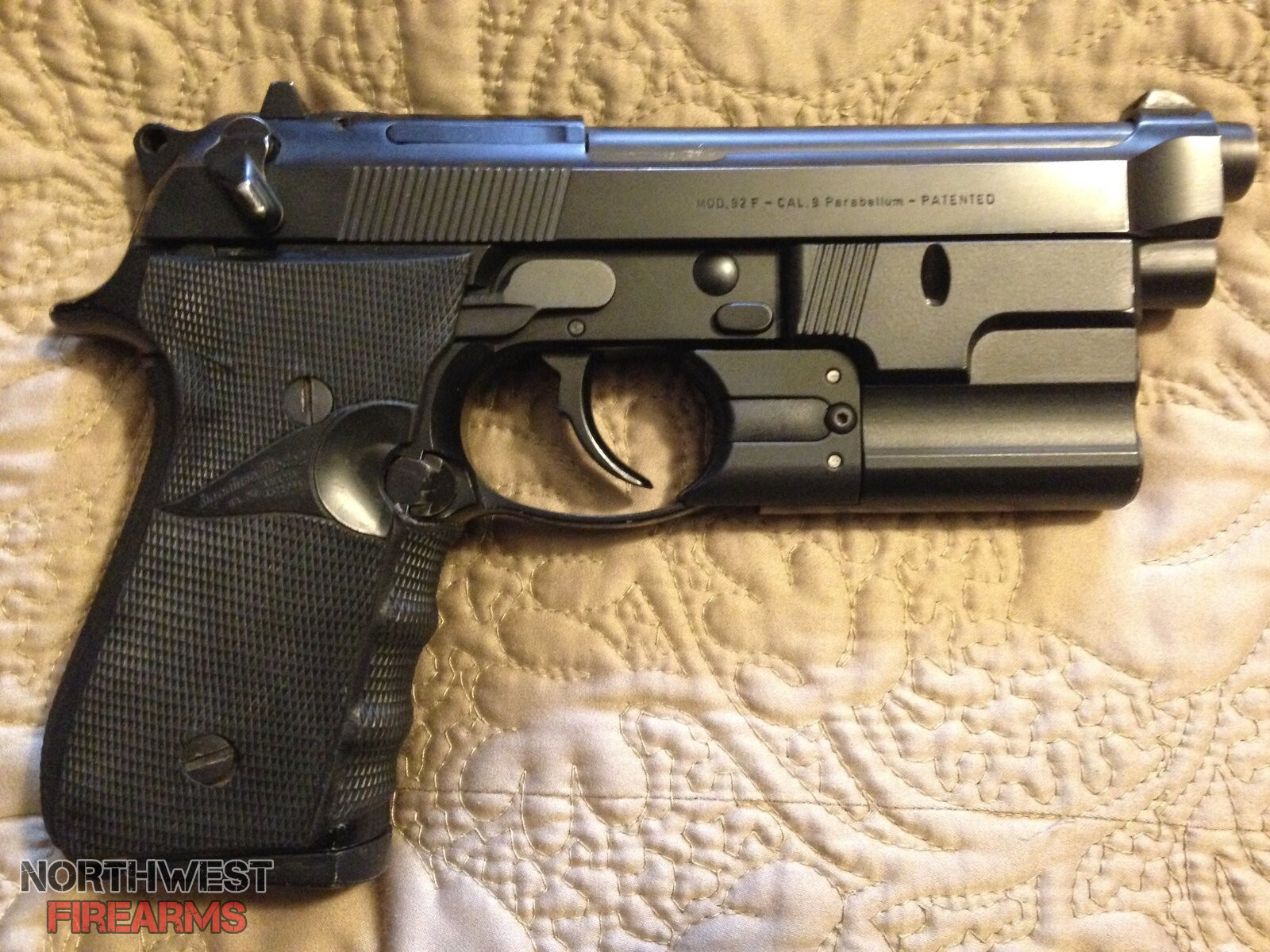

I have some Pachmayer wrap around grips on my Beretta 92F that I installed back in '87.... they're still good to go!
