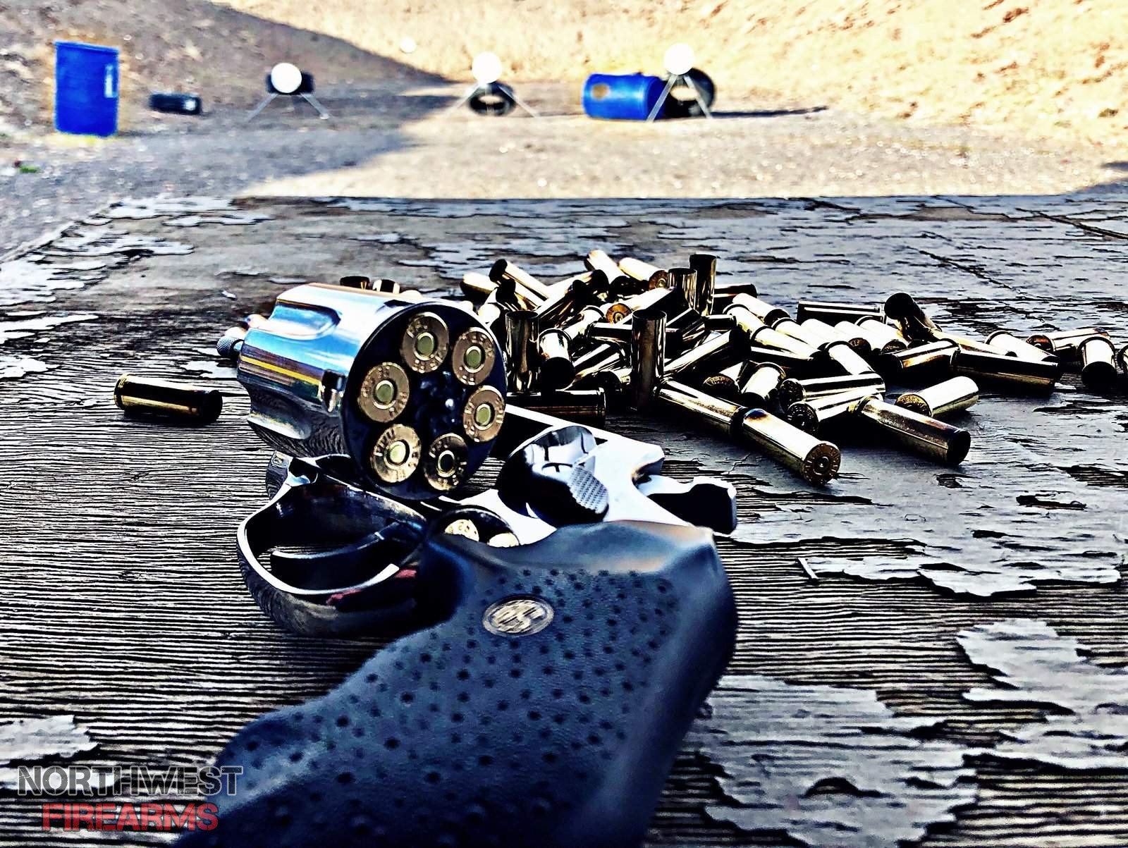

D5A47E7F-AF62-4C56-894A-76E50687B4EE.jpeg Interesting update. Thanks.
BTW, I did finally pick up a 462. Unlike my 461, it is in the affected serial number range. Sounds like it may be awhile before they start sending shipping labels. In the meantime, I'll keep enjoying it.
