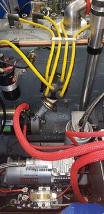

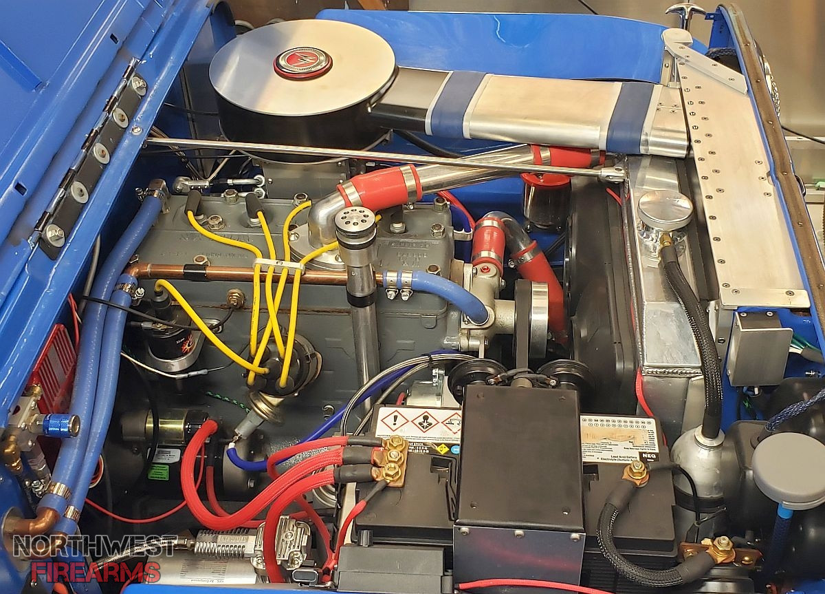

I had one heck of a time finding real copper jumper cables when I went to make up a special set for my Willys jeep (I have an Anderson Plug beside the grill to plug cables into like they do on a tow or service truck) I bought cables twice as long as I needed then cut them in half so I have a set made up for the Willys that is 10' long and material to make another set down the road.
On the actual Battery cables in the Willys I used high end Welding cable as it has finer strands and since electrons travel on the outside of the wire more stands is better for a given gauge. As to the Red and Black I covered my cables with TECH FLEX so I got the color I wanted that way.
