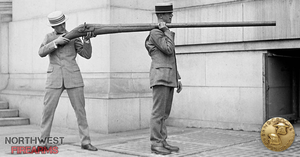

I think you need a punt gun. Shoots 1 lb of shot, gotta love that.
Just kidding.

Unfortunately the regs are 10ga maximum, otherwise a sitting fox k4 would be on its way to me.

Nope, federal rules govern waterfowl hunting, including 10ga max, 3-shell capacity, take limits, and largest legal nontoxic shot size. States issue the licenses but a federal duck stamp is required. This is a holdover from the feds banning market hunting and punt gun use. They have no problem with modern shotguns, muzzleloaders, or even archery for waterfowl, but federal rules are enforced by federal gamies when it comes to waterfowl hunting.
