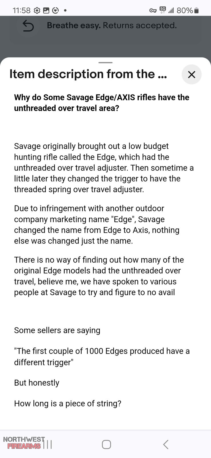

Correct mine does not have the accutrigger. It gets even more complicated with some of the early Axis (Edge model) rifles having no threaded hole for adding overtravel screw.
I will have to take mine out of the action to determine if I can use a kit like this.

Yeah, the same one on Ebay. At the time the only seller offering the kit. There was one other manufacturer that selling a pretty expensive kit way more I was willing to spend.
I will try some homemade fixes, if that doesn't pan out, I'll give the MCarbo stuff a try. Thanks for the heads up on ebay kits.
Not saying the ebay one doesn't work but I didn't feel much of a difference. The OEM spring was usable but the ebay spring took it to 4-5 lbs.
