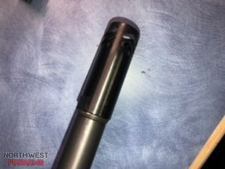

I thought it was cool except that they made the hangurd too long to fit a supressor. If they fixed that I think it would be a hit.

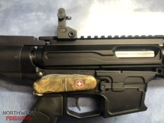

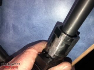

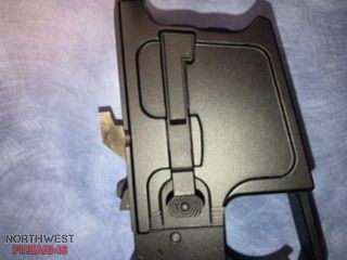

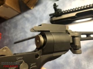

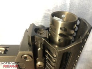

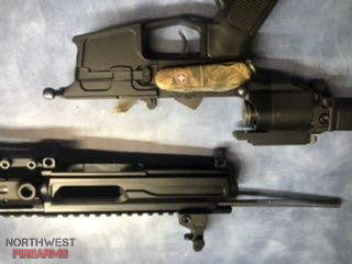

I found a barrel extension that is threaded to fit the end of the barrel as is and come out past the hand guard to mount mine. But the charging handle could have been way shorter. With the special upper and parts they could have made a different BHO point then standard ar. It makes the entire upper a mandatory length as it is.

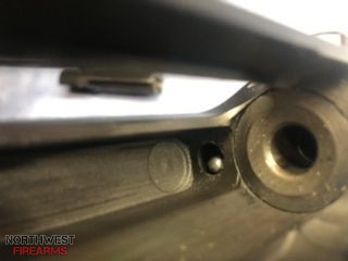

the hole for the op rod is 1/4 inch plus. It's huge. The rod is closer to 1/8". It has tons of slop it could have been refined a bit more to be a much smoother gun.
The charging handle hits the barrel when it's at the front position. It hits the barrel nut when you run it to the rear position to lock open the bolt. Don't get me wrong. I like it. But it's tougher then it could be.
The hole in the front of the receiver is .342. The op rod is .203 A ton of slop in it. You can see where the charging handle rubs on the break and where the barrel nut is filed down for the charging handle to clear for full rearward motion. The bolt is a two piece. The top part is screwed into the bottom with what look like a dove tail or post slot cut in to them to prevent moving. The upper receiver is not stock. Where a charging handle would be is full width. It is where the top of the bolt rides.
