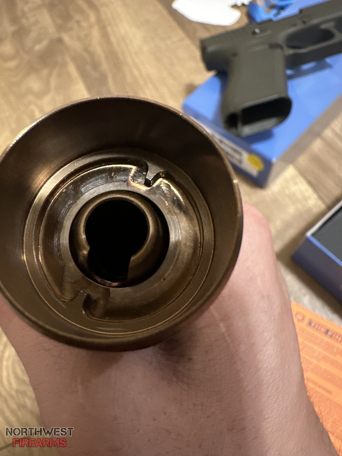

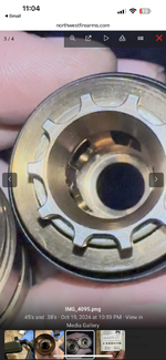

Until I installed it on my factory Glock 17 Gen 5 threaded barrel. I'm gonna do my best to explain this.
The piston has teeth that catch inside the encapsulator , which is the pistol housing I would call it. Well there are only 2 notches for the piston to catch and when it's set in the notches, the piston slides just a little back and forth: when this suppressor gets installed on the barrel it will move freely left to right. I have taken this apart and looked it over , it's. Spring, piston and it goes into the suppressor it's not rocket science , but it's shaking, and now I feel I need a rocket scientist to help me.
When those teeth from the piston go into those 2 notches. It's not a tight fit. When the suppressor is back together it still moves

That is a strange issue, I have a different Pistol Caliber can that has an excellent fit when I attach it and it's piston...
Make me wonder if your threads on your barrel is off or the threads on the piston is off.....
The threads on the piston have a big gap and seem oversized compared to those small teeth notches in the incapsulator. With the can installed I would never feel comfortable shooting this as I can grab my suppressor when fully tightened onto my barrel and rotate it back and forth easily,

I don't understand exactly what the problem is? If it just twists or rotates left to right or right to left that would be explained by their piston setup and I wouldn't worry about it. The piston's "sprockets" or whatever you want to call them should have a little play where they interface with the booster housing to account for fouling and it looks like Q just took it to the extreme.
Now if you can pull it left or right, or it droops when like when a pistol suppressor backs off as they are apt to do, where the barrel is no longer aligned with the baffle stack then that is a serious problem.

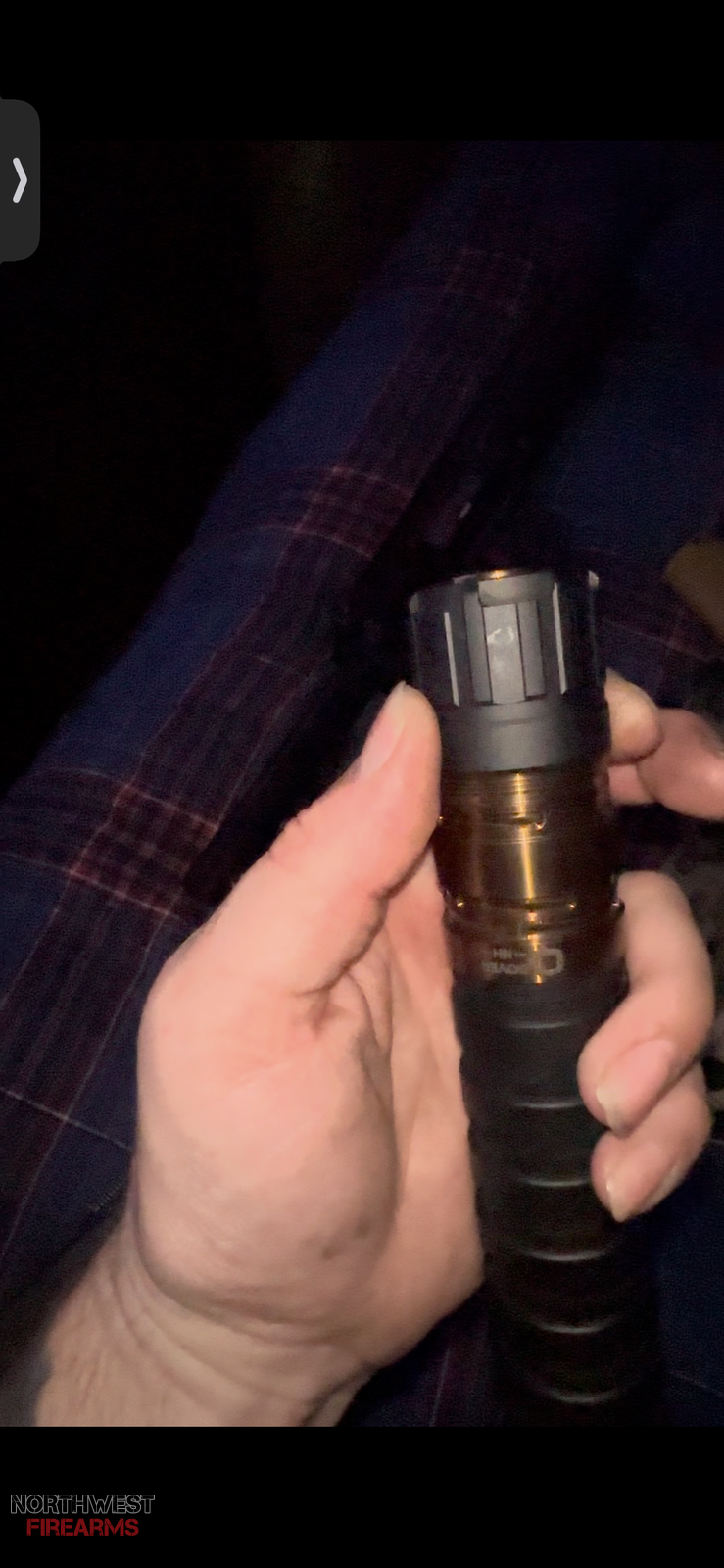

Ok the suppressor doesn't droop and it's tight onto the barrel itself, but the piston rotates in the booster as you said and I do not understand that they would make it rotate this much left and right , seems like a really poor design. How do I video
If I took this gun and swung it like a sword with the suppressor on I would bet it would
Rotate
Then it's normal but it's rotating much more
You can looks like it has several slots for the teeth to catch not allowing it to free spin left to right
I cannot figure how to upload a video maybe someone will PM me and I'll text them it and throw it up
But my can is rotating waaaay more than that and I understand they want to give it room to flex and rotate with the gun but this seems overboard and I want to confirm I did not get a piston too large or a bad suppressor from Q shoddy QC

Ok Terms here.
Nothing gets boosted so its not a booster.
Its not a encapsulator either. Thats an old MAC term for the piece that holds the spiral baffles in place.
What is it? Its a linear decoupler. It decouples the barrel from the silencer long enough for the barrel to move freely and cycle a browning style action.
Your decoupler is gonna do what decouplers do and thats let the barrel move without the suppressor moving so it unlocks. I meani its not THE best design but it'll work.
Had my buddy ask Q
Seems bizarre maybe I am overthinking things as it's my first 9mm can and I expected it to tighten down and not move even a little bit once installed , it's doing like almost quarter turns here
