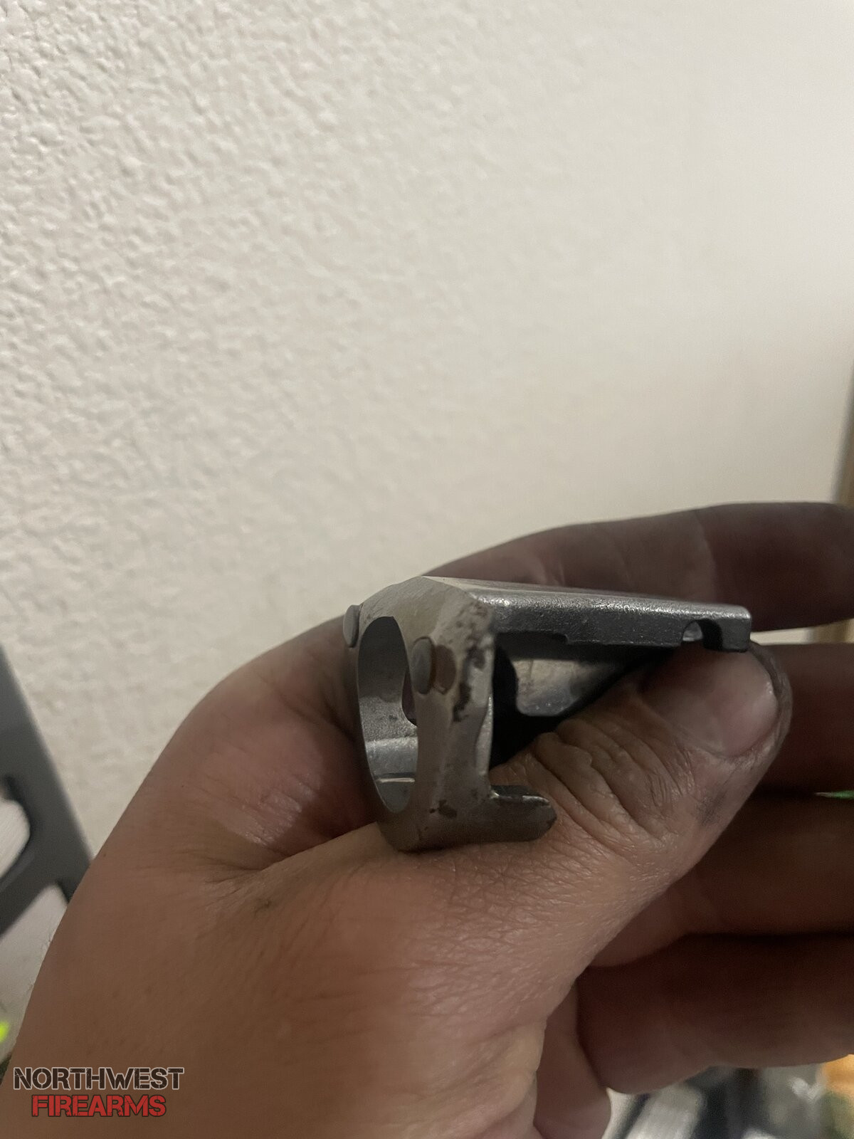

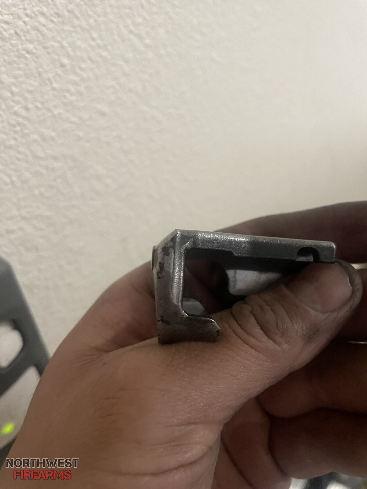

Like the ad says I'm looking for someone who is savvy in welding that might be able to weld a non firearm related item for me .
The item is the contact tip to a roofing nailer that's very worn down and expensive to replace so figured I'd ask around on here

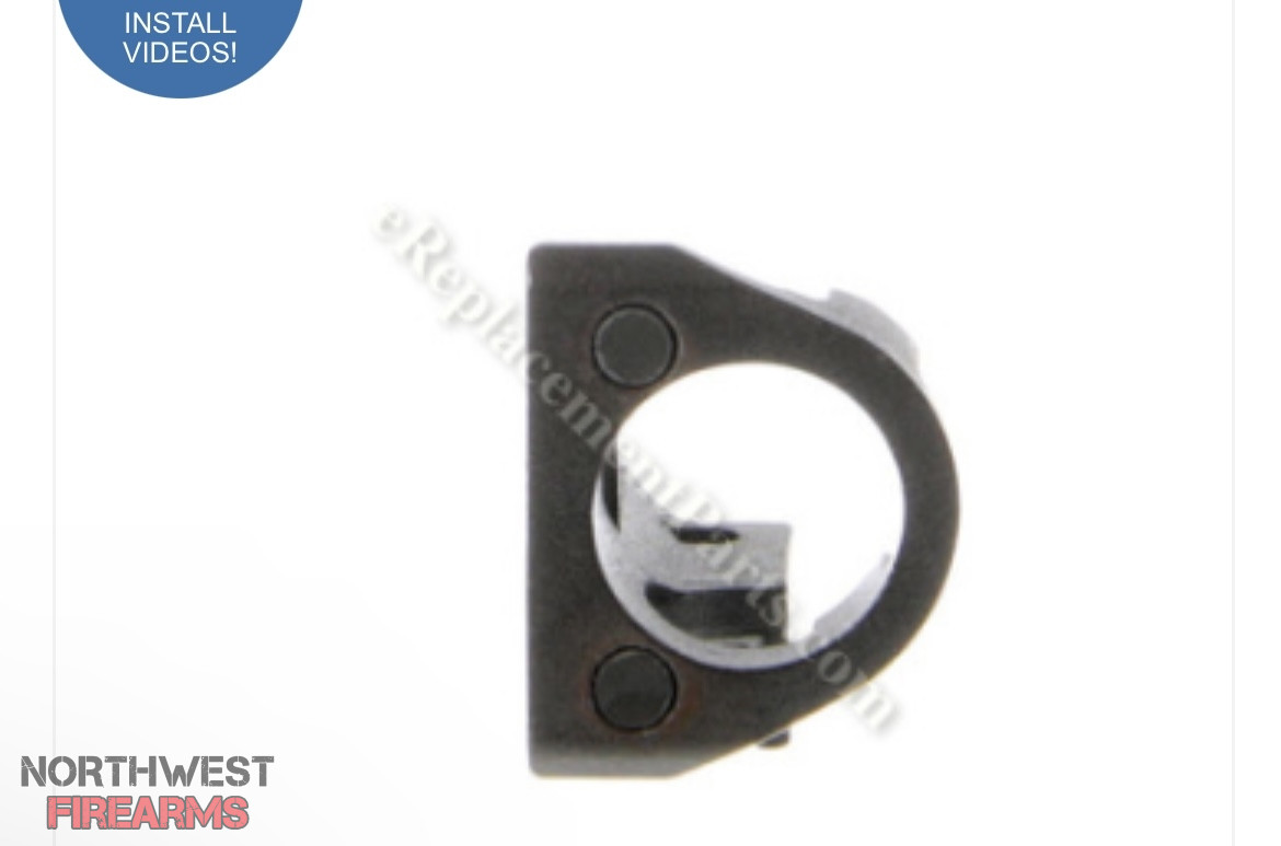

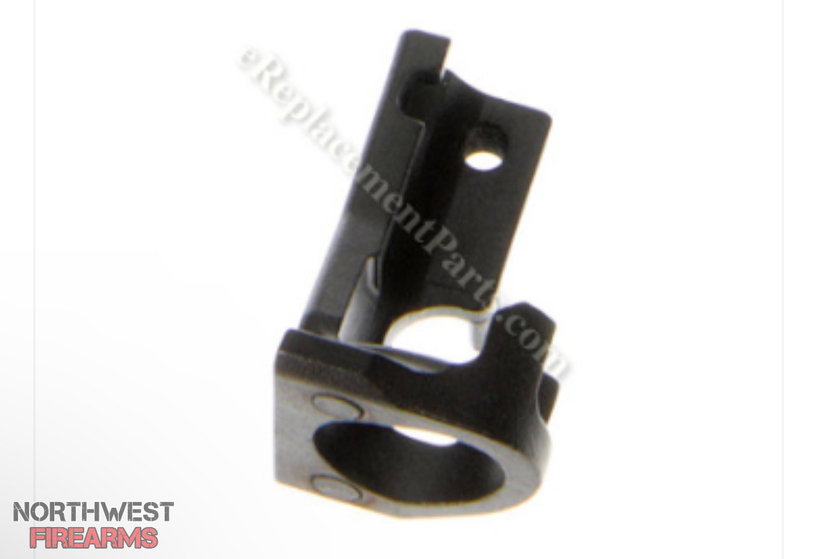

I will attach picture to what the item looks like now vs what I'd want it to look like once done
I can compensate in cash or ammo
I think you biggest problem is knowing what the specific alloy used to make the part, is.
This will be necessary to perform a correct weld.
I weld, therefore I am. :rolleyes:
If you can find someone that can build it up with Stellite, or similar hard-facing, the alloy won't be as critical and it will wear a lot better. A shop that repairs heavy equipment, backhoes, front-end loaders, etc., should be able to fix you up.
I've got a tig welder that should be able to weld that. If it's cast it's tricky but 304 stainless or braze can stick. If it's forged than steel or stainless will work, SS shouldn't wear as fast.
Send me the purchase link and maybe there's some material specs.
The welding is easy, but the grinding/filing is the time consuming part. A tig weld is pretty clean though.
