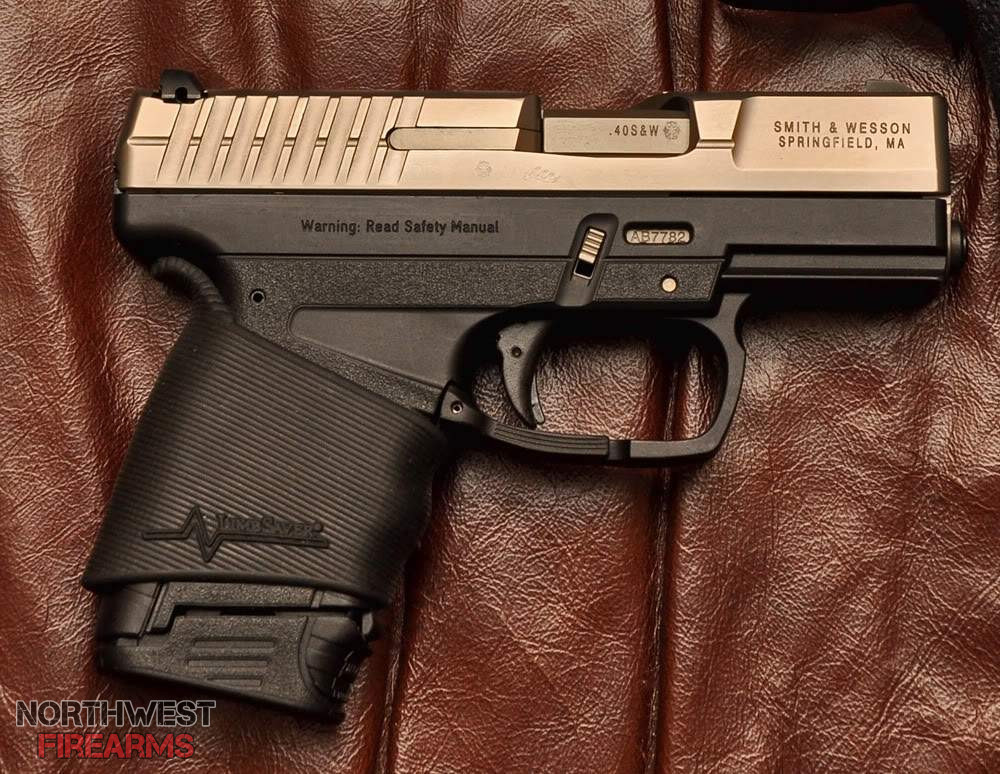

Limbsaver also makes a nifty slip on grip for handguns that is very comfortable and gives a very solid, tactile grip. Here is a photo of my little Walther PPS wearing the their compact model of that slip on handgun grip
That's funny - it covers the Walther logo. "Hey, that's a Smith and Wesson." :D
When the PPS initially came on the market S&W was still their exclusive USA importer and distributor. For some reason, they put the S&W name on the guns back then.
Both companies have since gone their separate ways. Walther now has their own USA headquarters in Fort Smith, Arkansas.
