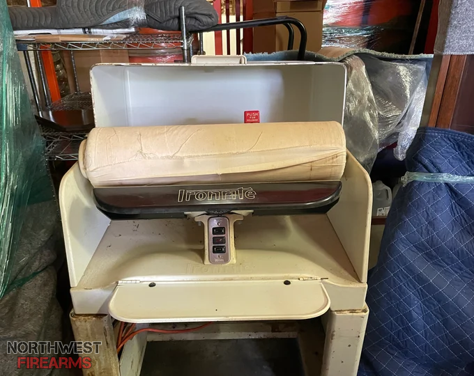

Anyway, Speed Queen. That reminded me, when I was a kid, my mom had one of those sit-down ironing machines with the big drum press roller on it. It was a Speed Queen. Back in time before Wash and Wear fabrics came along, and when lots of men needed pressed shirts to go to work.
Think about it, the trade name Speed Queen might be considered a misogynistic slur, implying that household appliances should be reserved for women's use.
"Ironrite"
A good friend's mom had one of those. We still see them from time to time in various shops and estate sales. Looked like there was a heck of a learning curve to 'em. And they must have been kind of spendy. My folks wouldn't but something like that in those days.
