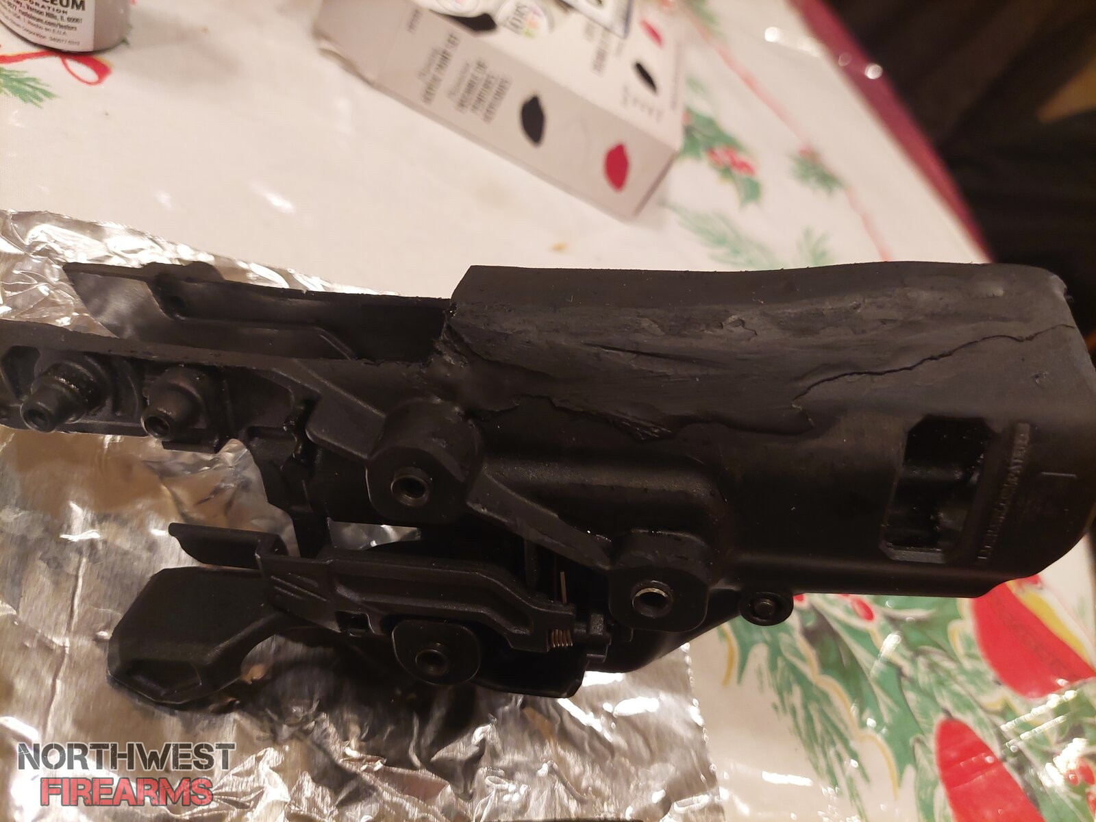

As of yet, no blackhawk retension holster exsists for a mp sw 2.0 10mm....but you can make your own
Need a G17 duty holster (no SURPA) level 2 or 3.
Disassemble holster
First, cut the top straight down the middle.
Second, remove the inner lining (its glued in an can be a real pill to pull out)
Make sure the new holster now fits the gun
Snip a long peice from the inner lining and glue on top to maintain shape (peice needs to be oversized)
Use a sodding iron to join the glued plastic to the holster.
Shape as needed (You might put in an optics cut)

Hello everyone,
Very few holsters exsist for the new 10mm SW 2.0. I have taken a blackhawk g17 and converted it to fit with an optics cut, see pictures below. To learn how this was done, please contact me
