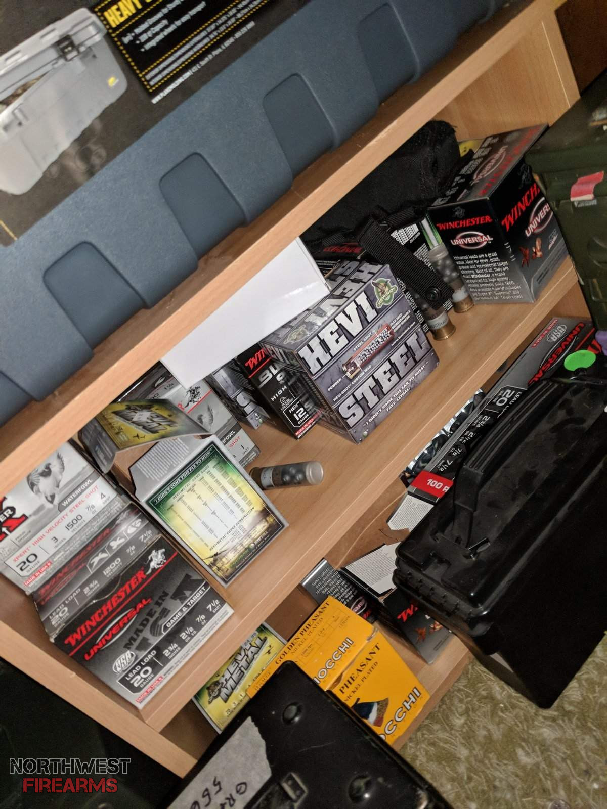

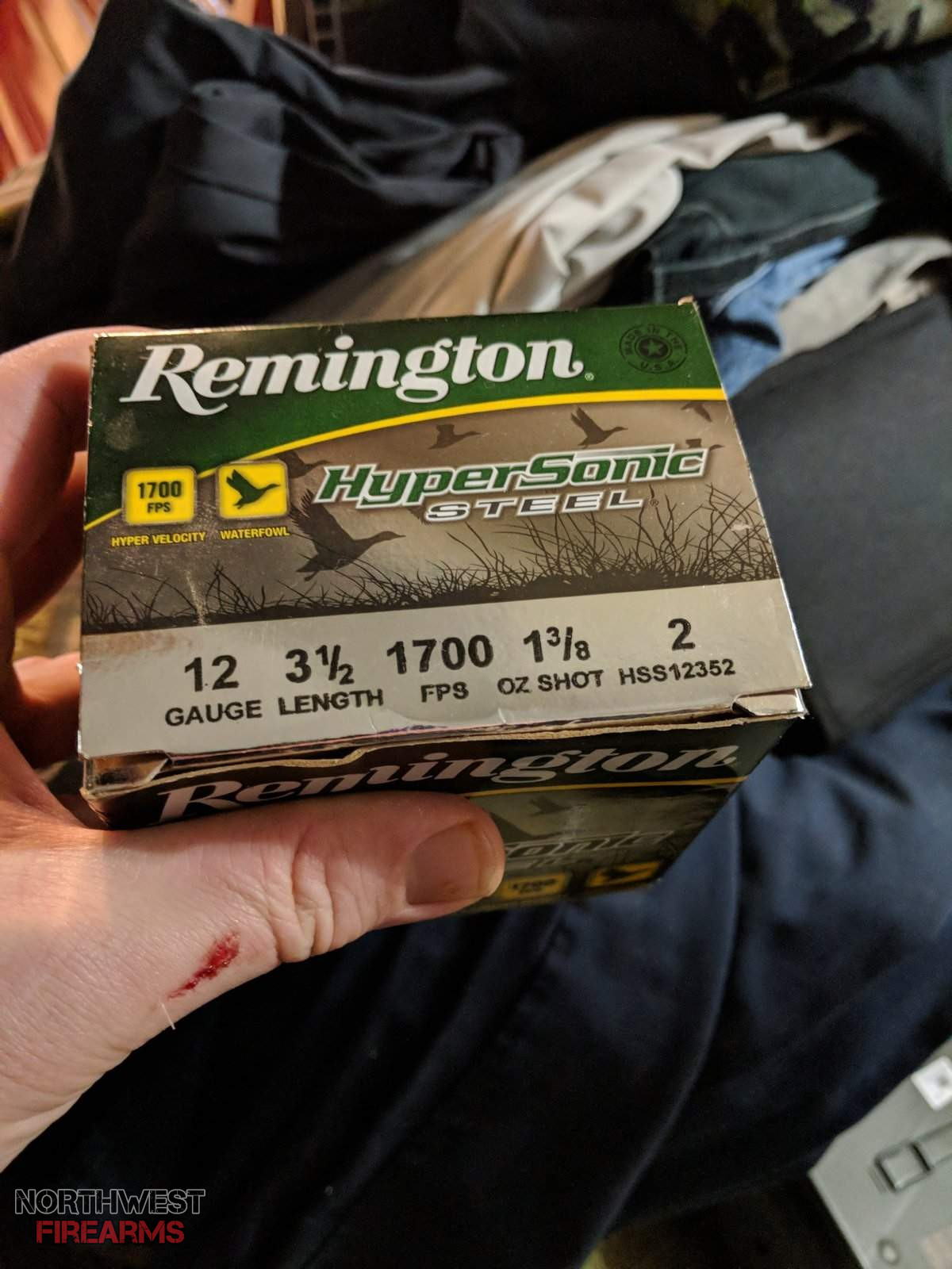

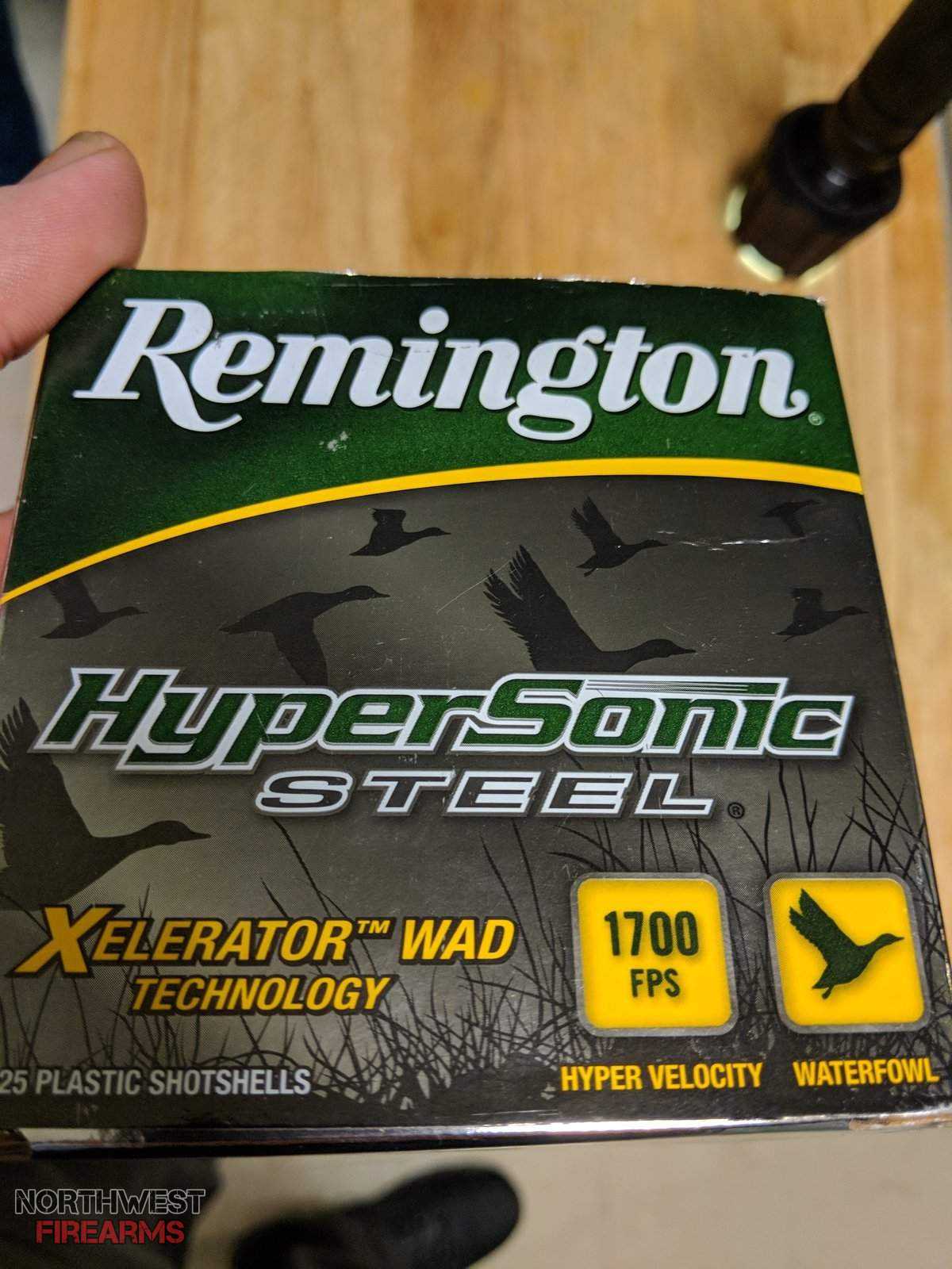

So now I'm on my knees looking through my shotgun ammo in my closet every one who has a choke on there gun should have read this if it is a full choke no ammo over 1500 FPS REMINGTON HYPER SONIC 1700 FPS and this is #2 shot 3 1/2 IMG_20180224_181036.jpg MVIMG_20180224_181336.jpg MVIMG_20180224_181924.jpg
