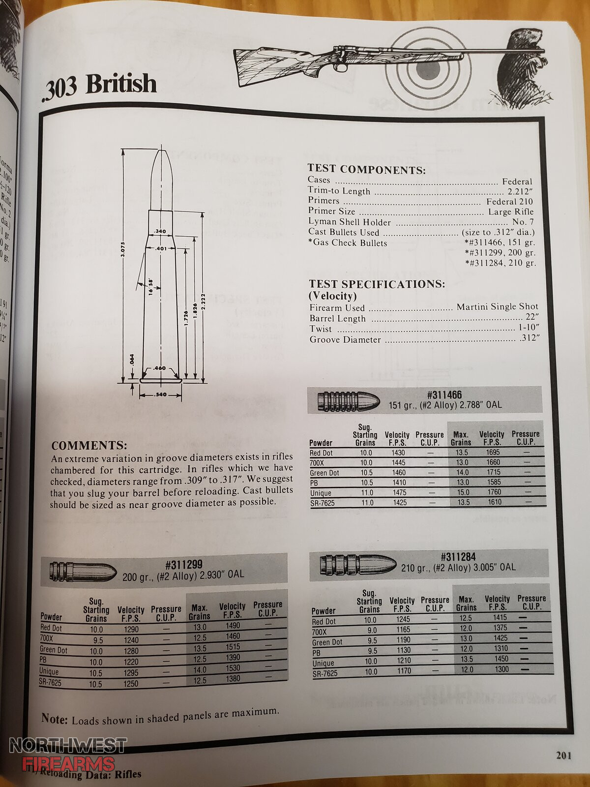

I need some data for 155g bullets for my 303 british please. A picture would be great
The data sent by umrek would be correct when you add a gas check. My old Lyman #44 manual list the same 311466 bullet at 155 grs. with gas check. I weighed a 30 cal. gas check and the 4 gr weight is correct. My book lists two additional powders that can be used.

Also noted in the manual is the following info for the 303 British
"An extreme variation in groove diameters exist in rifles chambered for this cartridge. In rifles which we have checked diameters range from .309" to .317". We suggest you slug your barrel before reloading. ********
Cast bullets should be sized as near groove diameter as possible. Bullet #311466 should not be used where a sizing diameter larger then .311" is required."
Hope this helps. There is more info about jacketed bullets as well if you are interested.
