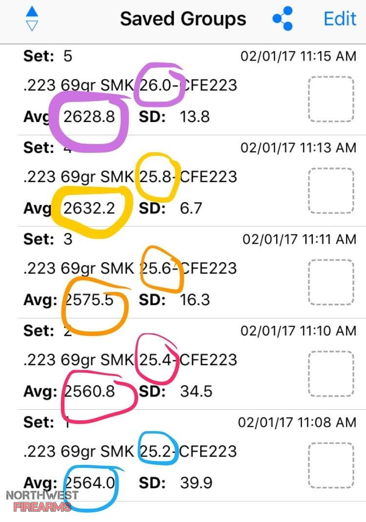

Interesting note about CFE-223:
It also likes barrels longer than 16". On my 16" barrel I went .2gr over max and appear to have LOST velocity.
According to Hodgdon and their website 25.8gr should be running 3000fps +\-. Find a different powder for a longer barrel.
Solution is to say it needs more room to burn because 50fps/in of barrel is excessive. (Even though these were shot sans crimp).
