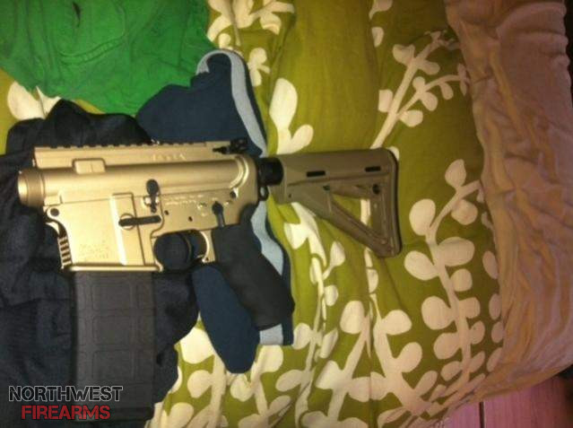

So i have decided to put together an AR from scratch, I do have firearm experience but this being my first ground up build I am looking to have someone check my work and able to kind of walk me through the rest of the process. I want to be completely sure this riffle is in safe working order before shooting it. Upper and lower are complete and the barrel/FF rail/ & gas assembly will be here in a few days. So anyone out there with a lot of AR building experience would like to help me out it would be much appreciated!
here is how it sits as of now...

as you can see in the pictures, the upper and lower are already assembled. I was looking for some check the head space and help install the barrel and FF tube since i do not have the tools for the and maybe take a peak at the rest of the gun to check my work.
As long as the barrel came with the extension installed the headspace should be good to go. Very rarely is there headpsace problems unless you mess with the extension. Find some one with a good FF wrench and an action block and the rest is easy. Those are the only two specialty tools I needed to do my AR
