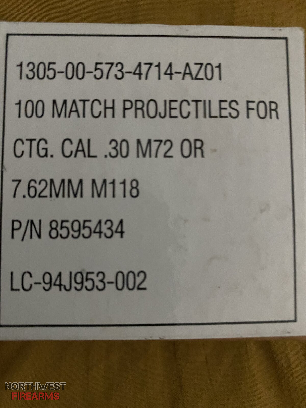

I'm assembling some 308 for accuracy.
Brass:
LC match
Projectiles on hand (don't recommend any others I want to use these)
Nosler 168 g HPBT match
Sierra 168 g HPBT match
Or projectiles in pic
Powder?
What combo would you load?
Info on duplicating Military Loadings

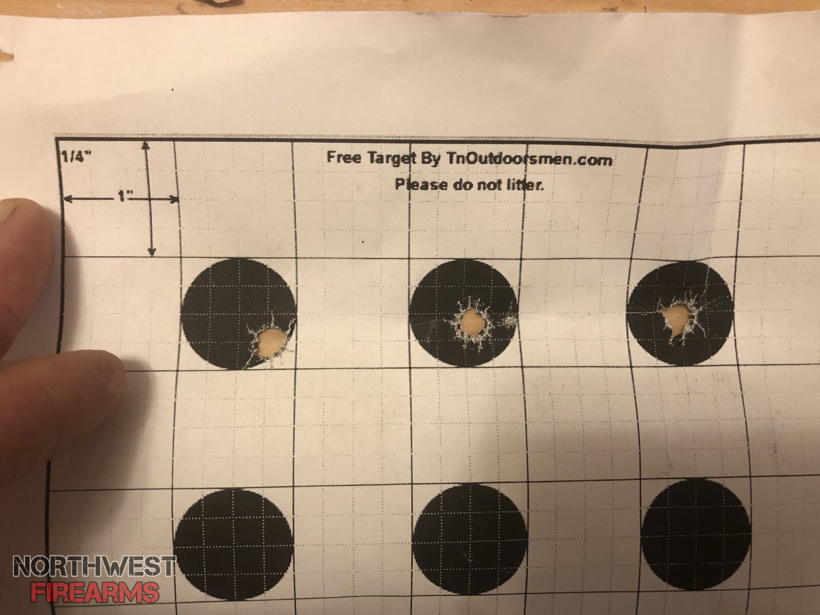

I get my best accuracy with IMR 4064 for the 308. My Savage rifle loves the 168 Sierra match King. Using LC brass I was able to get half inch groups at 200 yards.
