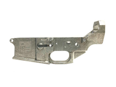

While I am taking a break from my firearm spending freeze, I am thinking about acquiring parts to assemble an AR10 based on first Gen DPMS components. What are your ideas for the least expensive options to do that right now? PSA has a stripped blem lower for $100 shipped today and BCA has complete 308 uppers for around $400. That would leave lpk and stock parts to complete it. Other suggestions?

Attention Armalite AR10 style experts. If I go with this lower what's the least expensive way to build it? I have AR15 LPKs on hand already.
Armalite style upper receivers appear to be harder to find than the dpms varieties, any leads on a cheap one?
I am suspicious of blems in the white. If it didn't even make it to anodizing, why would I want to shoot it?
Armalite lowers are only compatible with Armalite designed uppers, and I have only seen Armalite on Armalite.
