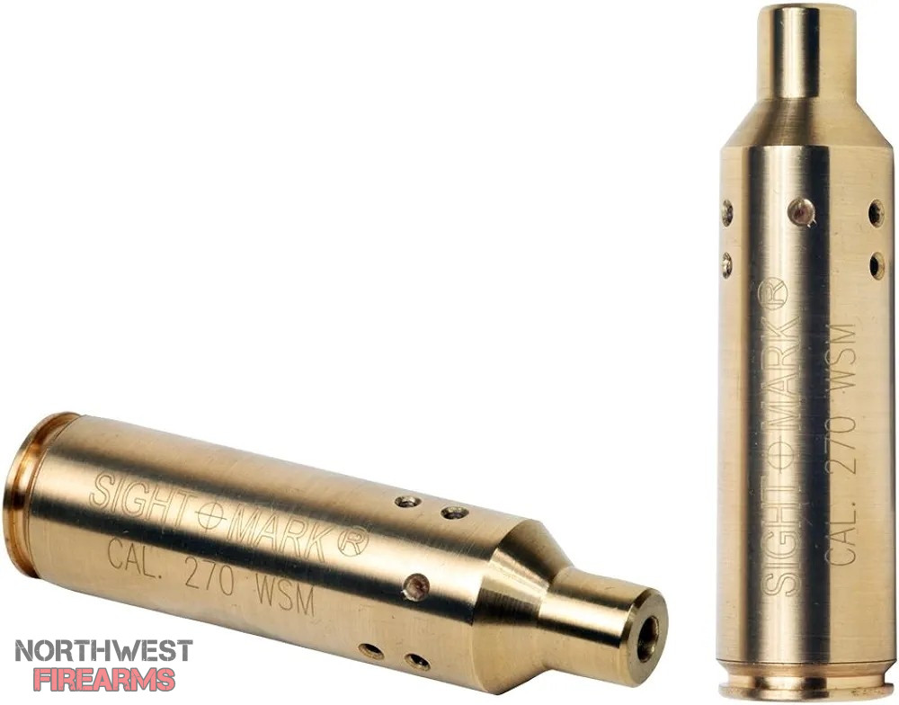

Thought I would give one of the "in the chamber" lasers a try, thinking that they would be the cats meow. Well was I ever disappointed, I was barely on paper at 25 yds. The scope was adjusted to the laser at 25 yds, first shot was low, left almost 10 inches at 25 yds. How does that even happen? 1728268696780.jpeg

They just aren't made very precise.

The cheap cartridge lasers are not accurate. The kind that emit a laser only when the hammer strikes them can be used to train yourself for point shooting. They also work well in dry firing close up such as using "I target" or other phone dryfire systems. This will give you a readout on how fast your draw is etc. The cheap ones work great for that.
There are more expensive ones with three orings for a precise fitment. They work much, much better. They cost more though ELMS is the name. The cheap ones are good only for the 2 purposes above imo.

Bore sighting with the chamber never really had a chance, the end of the bore tells it where to go.
