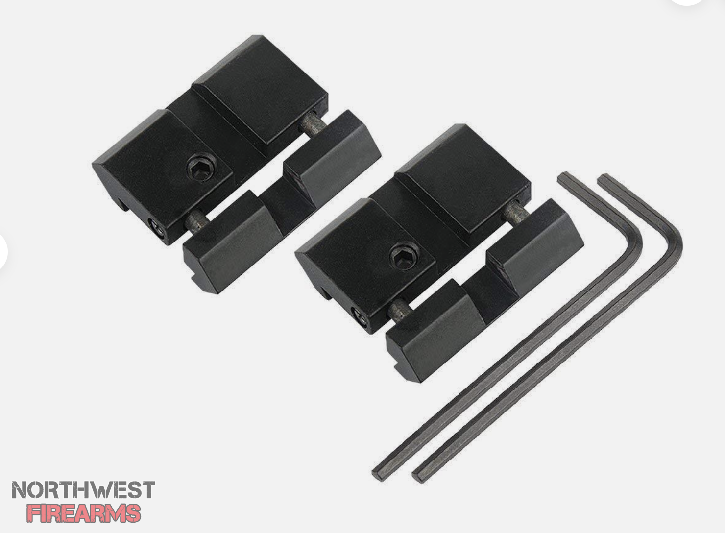

In the meantime I'm going to get one of these, approx $13.00. I think I have a set of Leupold QRW rings somewhere. If they don't work, well they aren't going to break the bank.

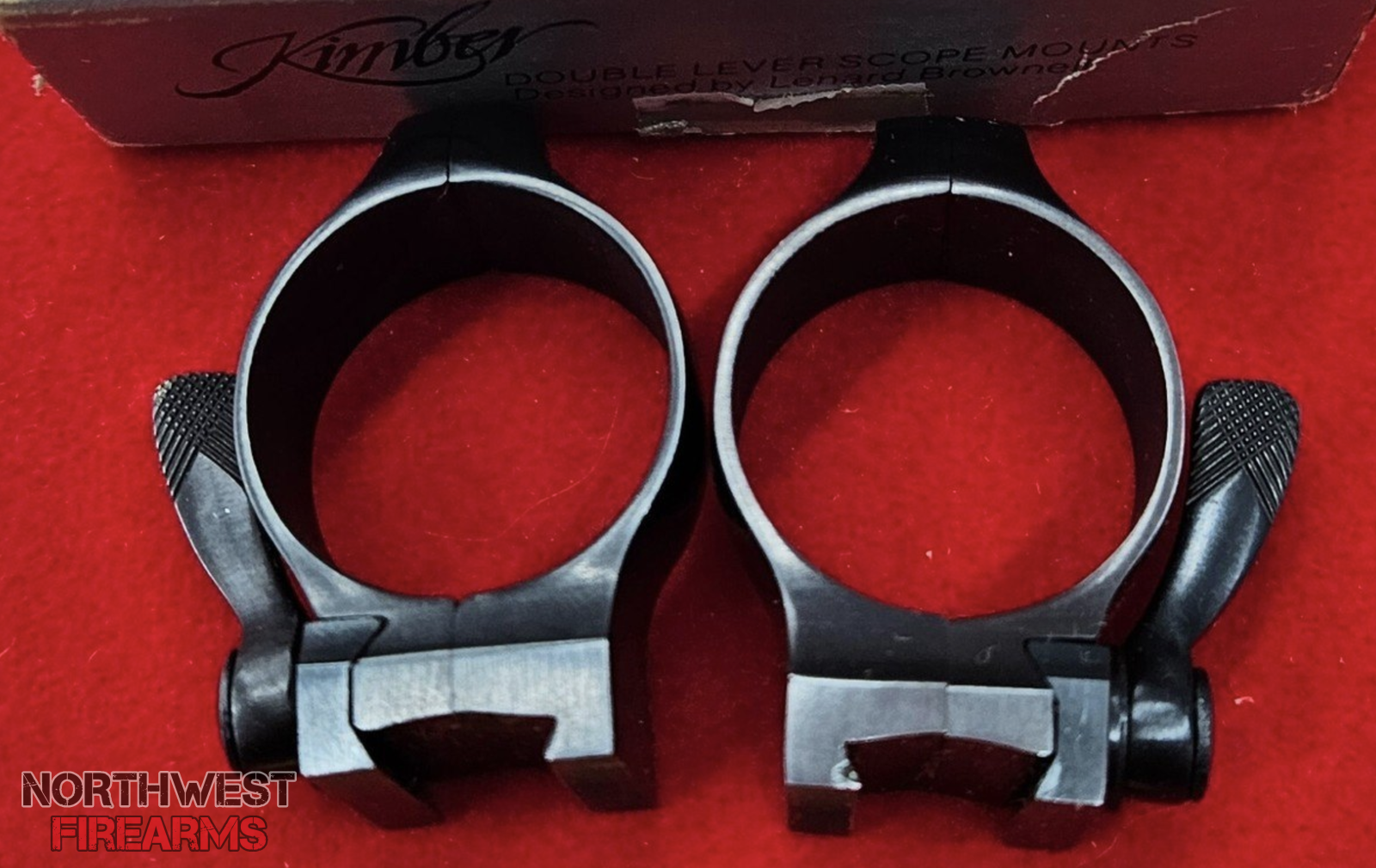

Found a set that isn't break the bank price. They are original Kimber of Oregon rings that have the curved base for the Model 84.

Ended up buying these.
I gave the dimensions of the scope to Talley and they gave me a part # of 22TRL which list them as 22 Anschutz 1" steel rings. I decided against the original Kimber rings with the lever for the simple reason I don't need to take them off and on as there aren't open sights on the rifle.
After chatting with a Kimber of Oregon collector I bought an original set of high rings from him. I didn't want to take the chance of the Talley rings not being high enough for the 44mm when I get the rifle and having to then wait even longer to get rings that would fit.
