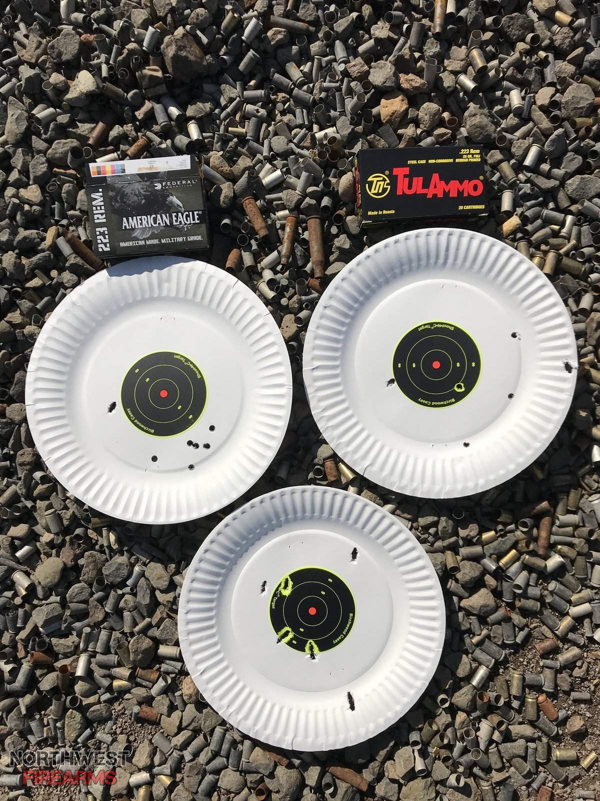

I have a late 90's mini-14 that does not like my reloads. It has always had accuracy/tumbling issues and I assumed it was just that the barrel was worn out from heavy use back when Wolf 223 was under $90/case. Today I brought 3 loads to the range: American Eagle .223 55grn, Tulammo 55grn, and my reloads (22.5 grn H322 + 55grn hornady FMJ. All shots were taken from 50yards on a semi-stable bench. My reloads key-holed terribly with many missing the paper plate completely, tulammo didn't keyhole but was all over the place, and the American Eagle shot a decent group. I repeated the test twice with identical results. The only difference I noticed when shooting was that my reloads ejected at the 90 degree angle to the gun while the AE pattern was further back. All bullets were 55grn and I have had a lot of success with these reloads in various AR-15's. Does anyone have suggestions for why my reloads suck in this rifle?
I'd guess the twist rate vs the bullet weight vs the FPS have something to do with it. Either that, or we can fall back to the obvious that it's a Mini 14. Have you ever chrono'd your load?

Probably a 1/7 twist for that year. I'd try heavier slugs after checking the crown for damage.

Still shouldn't have mattered though, as 1/7 usually shoots 55gr just fine. I've heard some reports of decreased accuracy, but not keyholing. Trying some 62gr would be a good test, though.

If it was crown damage it should be evident on all 3 loads, not just 2 out of 3. Velocity shouldn't be a problem either, as I've shot plenty of 55gr out of 1/7 barrels. The exception would generally be thin-skinned varmint bullets at high velocities, which can come apart completely mid-air. The Hornady 55gr FMJ-BT is usually considered the best (and most accurate) plinking bullet available for reloading, and shouldn't be the problem. Something else is going on here...
I also looked up his load data, and 22.5gr of H322 is warm, but below the max of 23.1 (per Hornady #6). Velocity should be 3,050 out of a 26" barrel, which should put his velocity around 2,900 fps, give or take. I believe TulAmmo is on the slow and weak side, but the American Eagle should say 3,240 fps on the side of the box and be roughly equivalent to XM193. I'm starting to wonder if his bullets are going too slow to grab the rifling, but that seems unlikely. If the barrel is really worn though, maybe the reloaded bullets aren't obturating enough to fully grab the rifling, but the faster (higher pressure?) American Eagle is. First thing I'd do next is check the bore size at the muzzle using a cartridge, and inspect the crown as you gentleman recommended.
Definitely an odd scenario. It might be worth having a gunsmith mic or slug the bore, or possibly even do a chamber cast to see if the throat's shot out.

If that we're the case I'd think it more likely that the American Eagle would fail too. Inconsistency is symptomatic of ammo differences more than barrel problems.
Hodgdon shows that's a good load but in a 1:12 twist. Might just need to slow down for a 1:7 twist. Berger twist stability calculator says that combo might be unstable.

If he needs to slow down, how does that explain the higher velocity American Eagle shooting the best?
Having a slower bullet would reduce RPM, but it's the slow bullets he's having problems with.
