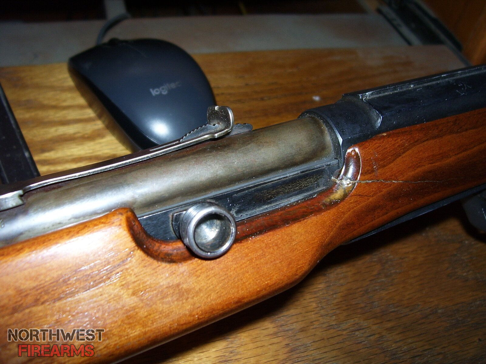

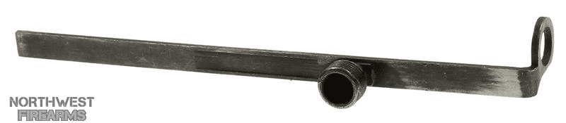

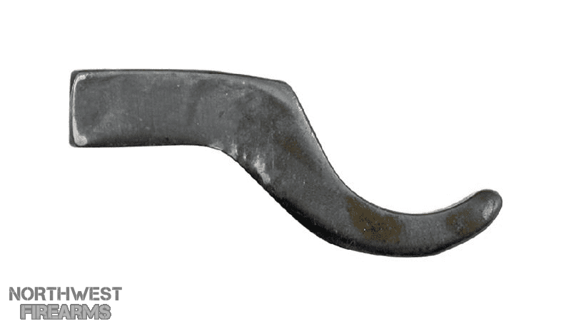

Mine is different, it is on the right side. Takes a flat form pc of steel that sit across the top of the bolt.
Ahh, that is the other model and should be the same as the 27,28 and 29. Might be able to use one of these below from Model 34 hi standard ... https://www.gunpartscorp.com/products/356600E
