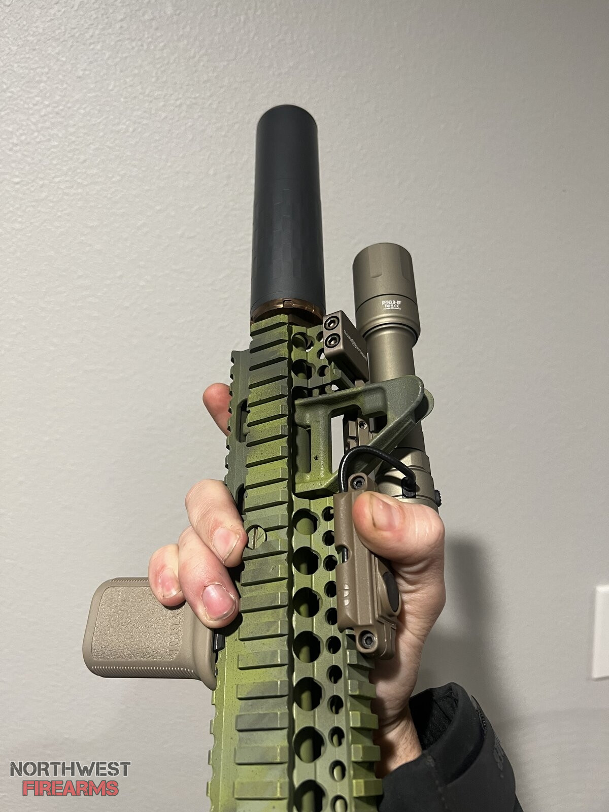

Doing some mock ups with my existing WMLx trying to get it to work with my preferred grip makes it a no-go. I use a C clamp and want the button to be near my thumb, so I tried it with a 45 degree offset mount, and the mount base interferes with my front BUIS unless I back it off a M-LOK slot towards the reciever, which shortens my grip length. Doable with the 14.5" 5.56 upper, but the 10.5" upper is just not comfortable.
I want these rifles to use the exact same gear so there is no hesitation under duress if I need either for self defense. I'm going to use the ergonomically similar Streamlight TMR RM2. Because of it's aluminum construction the mount area is much slimmer, so I can position it where I want. The non laser version w/o pressure tape (which I don't want) is about the same price.
