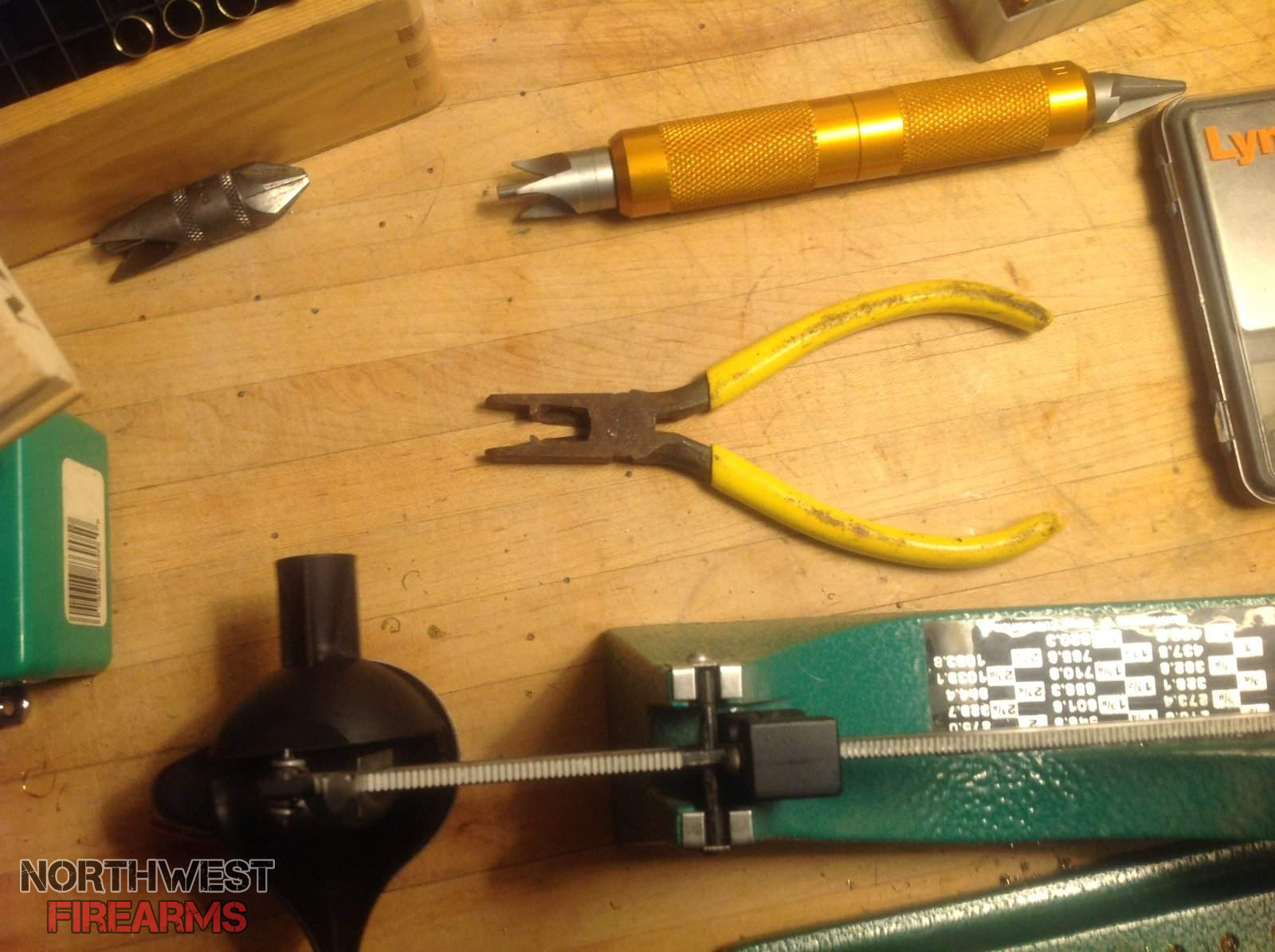

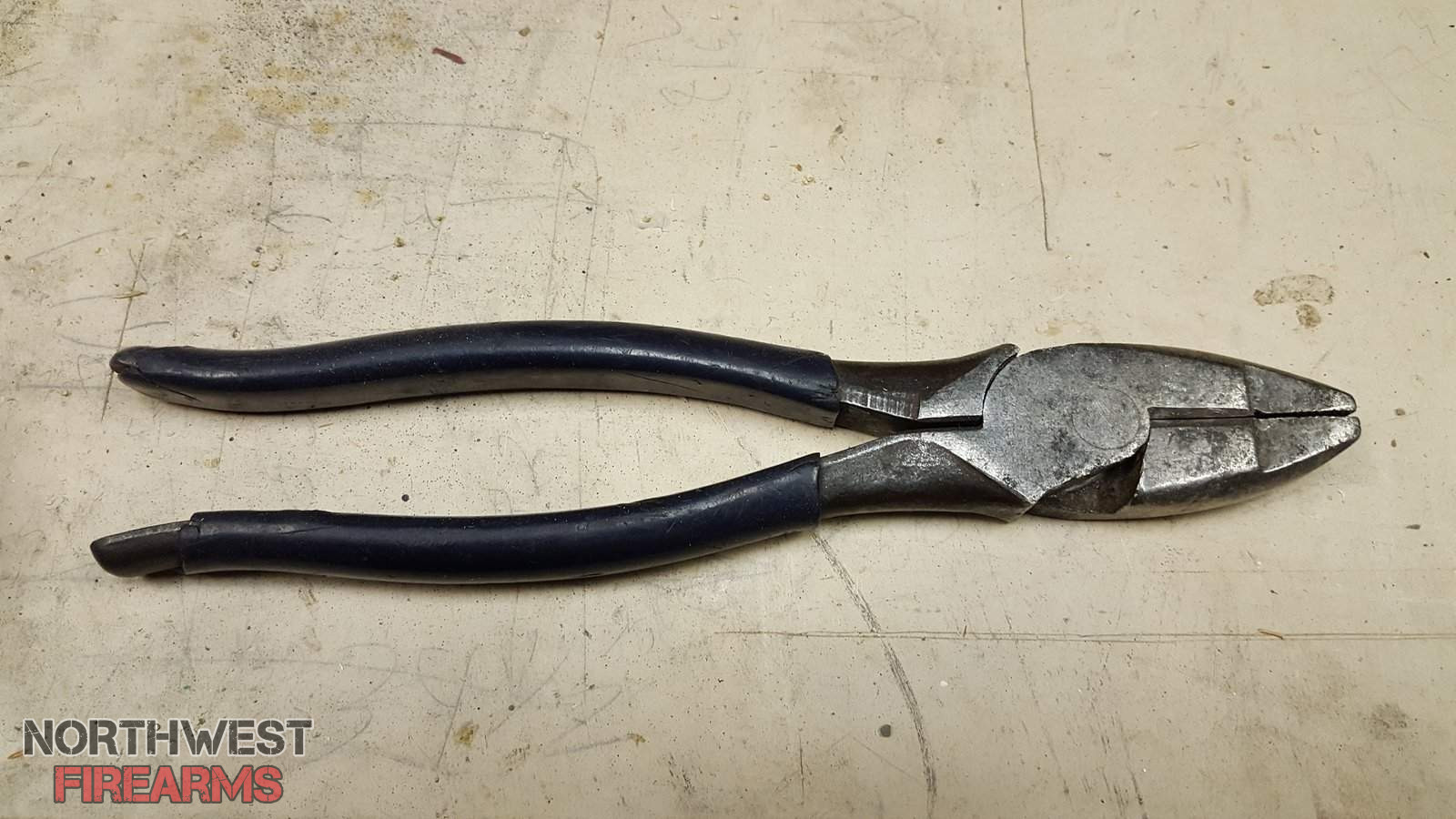

Those scotchlock pliers are SOOOO handy...
As are a lot of hand tools including the hole punch for sheath bonding..... these Nines are over 50 years old & still kickin.... lol
I figured as a splicer you may have squeezed a pair once or twice. ;) I had to splice the occasional 6 pair, but only cuz I accidently plowed through, or bored into it (and a few larger ones:rolleyes:)with my Maxi-Sneaker.
We contracted for Quest(US West at the time) and buried the lines from the street box to the house (S.N.I.)... I quite liked that job. My toner is other tool that I have left from that job that I find quite handy.
