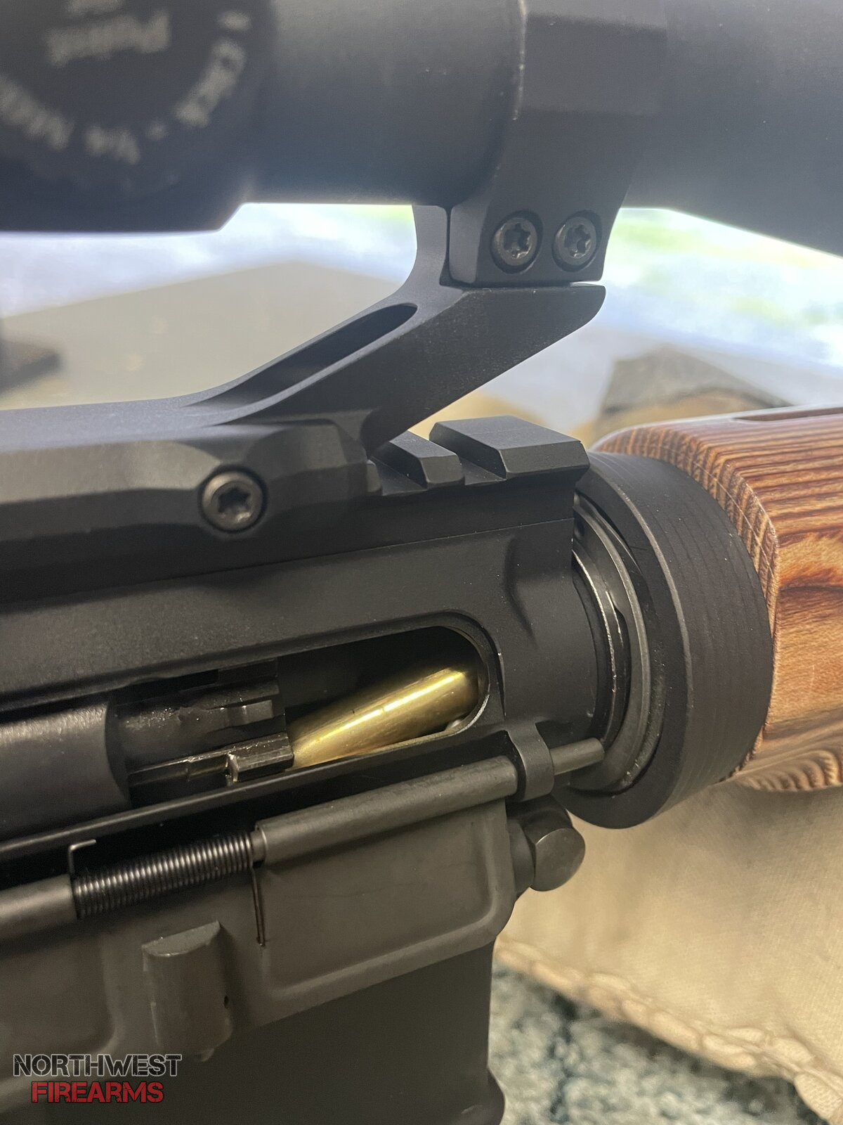

Just got back from the range with my son, trying to get a couple AR's running reliably. No luck, I don't believe that it is a reliable platform. Ranting here but I have several AR's that ALWAYS jam, factory ammo and reloads the same. AR10 too. What type of jam is this, it's a live round that didn't make it into the chamber, this gun has never locked open on empty mag either. Rifle length has system. Also, my stupid AR10 doesn't have enough oomph to push a round far enough into battery to fire the next round. Really frustrated. The only reliable AR's that I have are blowback 9mm's.

looking at that photo my first guesses would be bad mag, improperly loaded mag or wrong buffer or buffer spring. Maybe a Carbine buffer spring in an A2 stock tube. @kmk1012 can you measure your buffer spring and take a photo of it? What brand of mags are you using? Are you using one brand or have you tried a few? Did you build the rifles yourself or are they factory built?
Are they factory rifles or "builds"?
I've owned many AR's, mostly factory rifles, including an Armalite AR10 that would digest anything. None gave me any trouble with normal ammunition.
I did try my hand with two or three minor builds, that is, I bought already assembled uppers and put together the lowers myself. I never had any issues with those either. But I repeat, I didn't put the uppers together.
So in my limited experience, AR's have been reliable firearms.

For the record, all of my AR rifles, including my builds, are reliable enough that I'd trust my life with them. Then again, reliability is my first priority. Like others have said look at ammunition (I use either Lake City or my own validated hand loads), magazines/followers, feed ramps, even look at lubrication.
If all your AR's have issues, that tells you to focus in things they all have in common, which leads back to just about everything above.
One thing that can come into play is trigger hammer mass. A lot of non mil spec triggers have low mass hammers. That extra mass on the hammer is there for a reason. It's why I stick with triggers like the ACT and the SSA-E, even though there are really great ones out there at better prices.
Are these factory guns or assembled from parts?
Not to diminish your experience with the platforms reliability, but rather to bolster your hopes, I have had the exact opposite experience with AR's. Keep at it you will get it resolved. Trust me, when the components are not defective/out of spec and they are assembled correctly with a gas/buffer system that is properly tuned, the platform is ridiculously reliable.

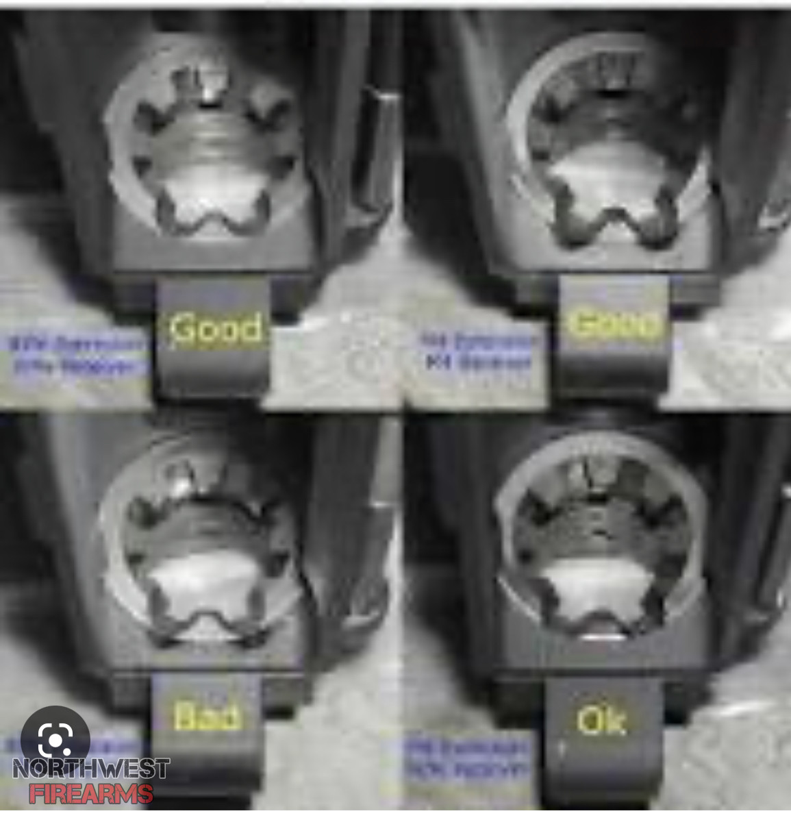

@kmk1012
Some reading I was doing, a while ago….about feed ramp matching between barrel extension and receiver….. there's a couple patterns totally…. But even matching ramp's could have little ledge to hang up on.
Something easy to look at….
@kmk1012
Looks like a great article at first glance, when I get back home I'll thoroughly read it, thank you.
