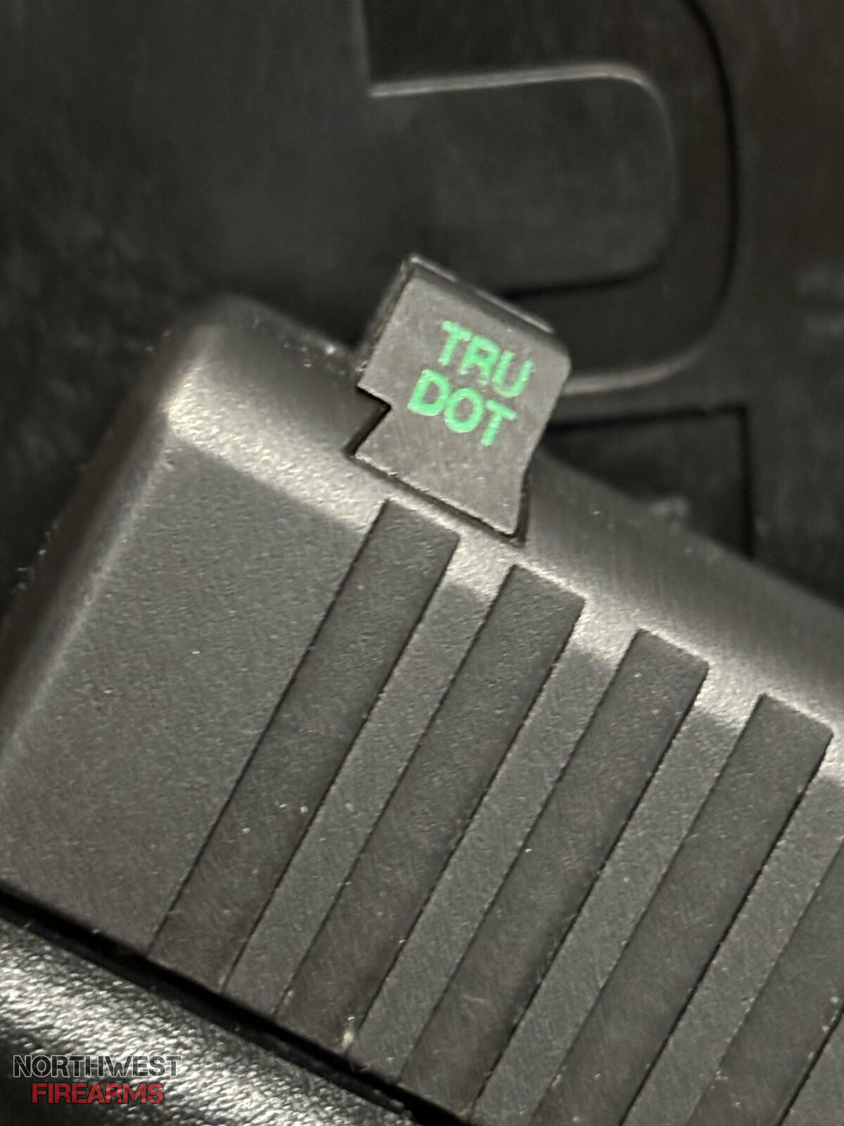

Centered, functional but ugly... will be replaced so I want to do it right.

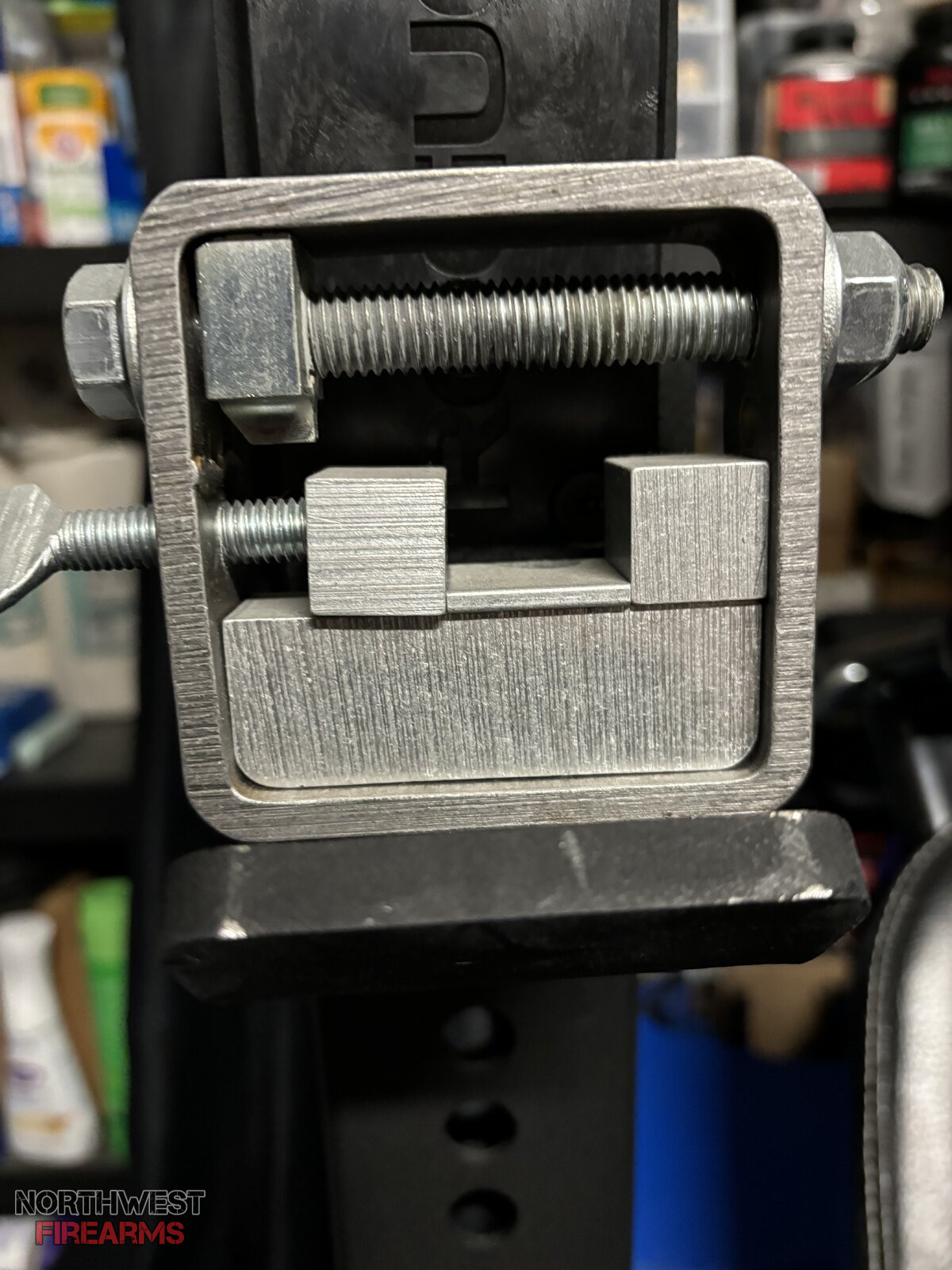

Heres a pic of my sight pusher for reference, its an old school design that was once popular.
I've got an inexpensive one along this line. It may be used on many different gun designs if set up right. So far, I've only used it to nudge my Glock rear sight so as to get centered on the target.

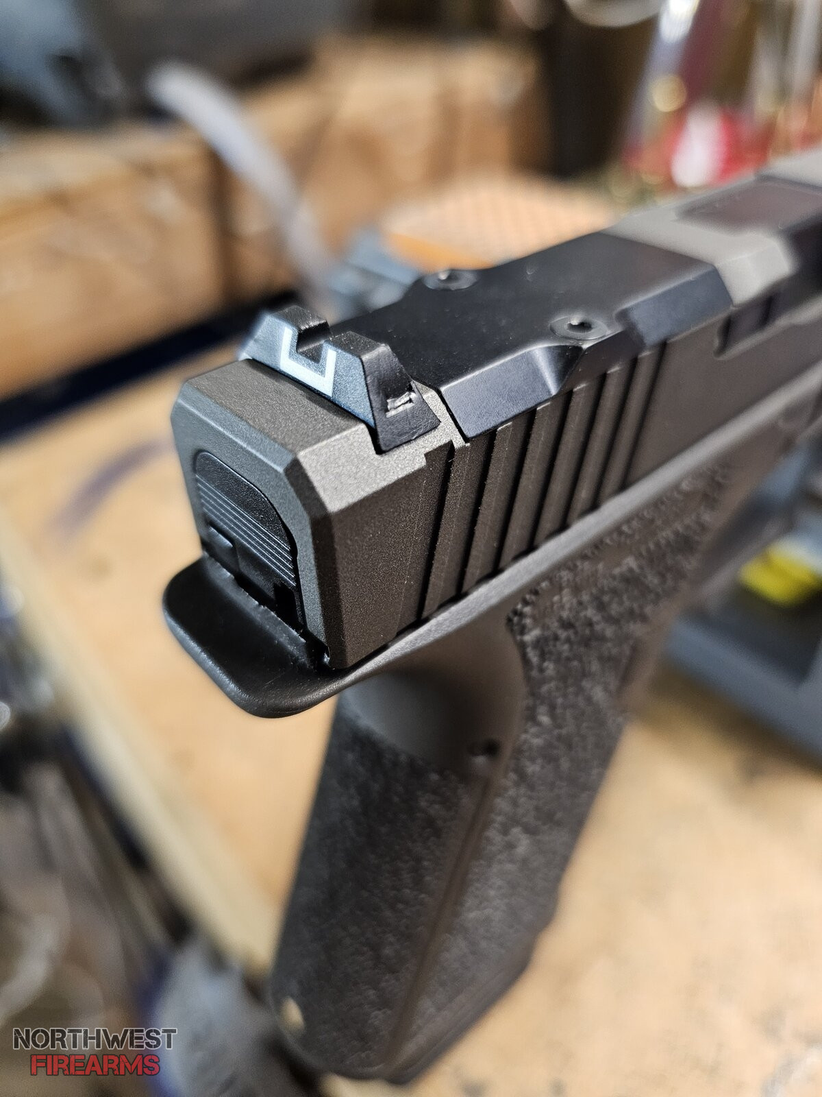

Here's the sight pusher used:
And the new rear sight on a G19, Gen2, sights were pushed from Left to Right:

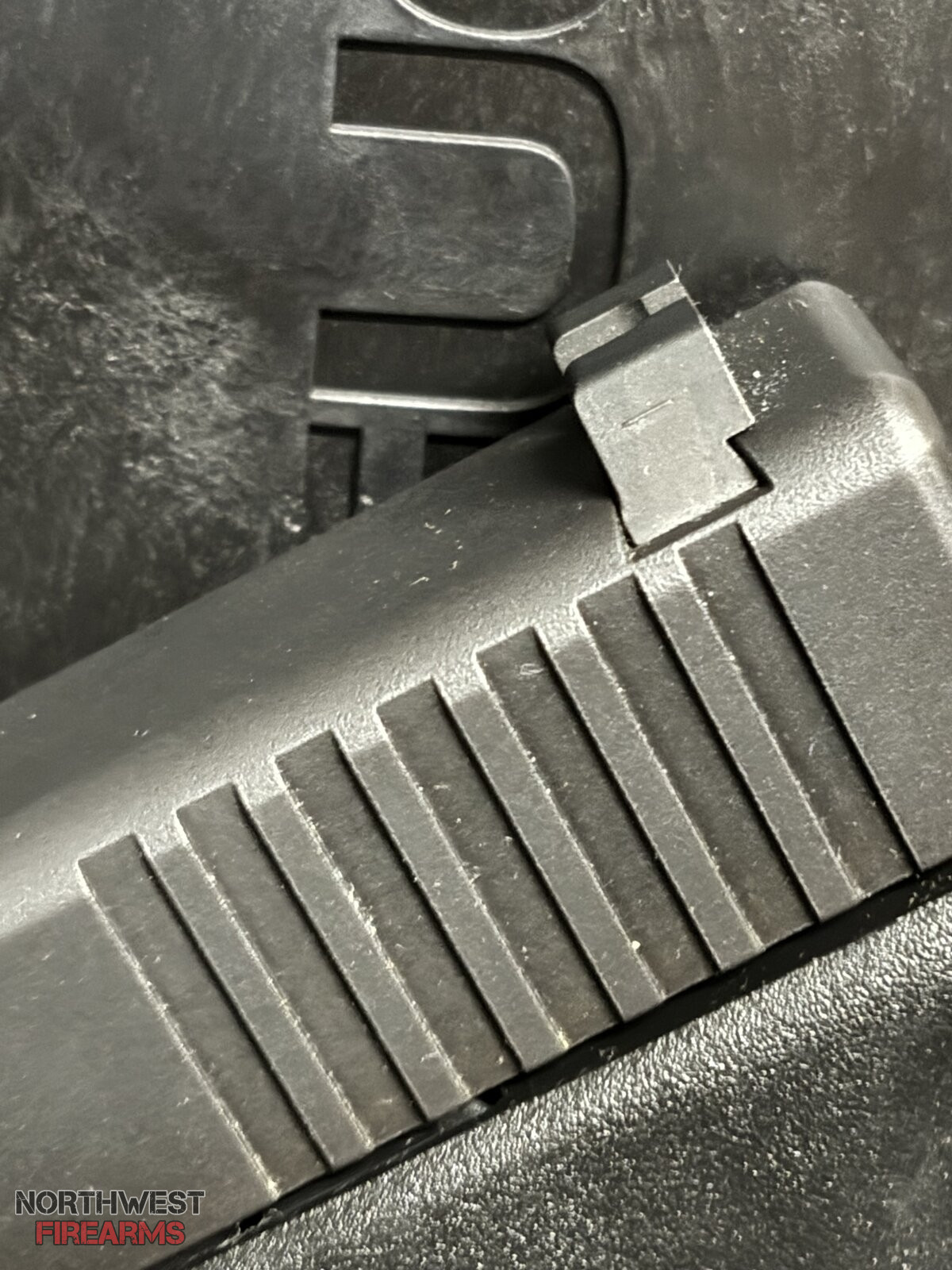

My understanding is the dovetail grooves in the slides are not tapered (directional) but many of the sights are, or rather have a slight bevel on one side making them directional. Ive never heard which direction is correct, but if you have calipers you can measure the width of each side of the sight and if one side is slightly narrower thats the only direction it should be installed and removed from.
