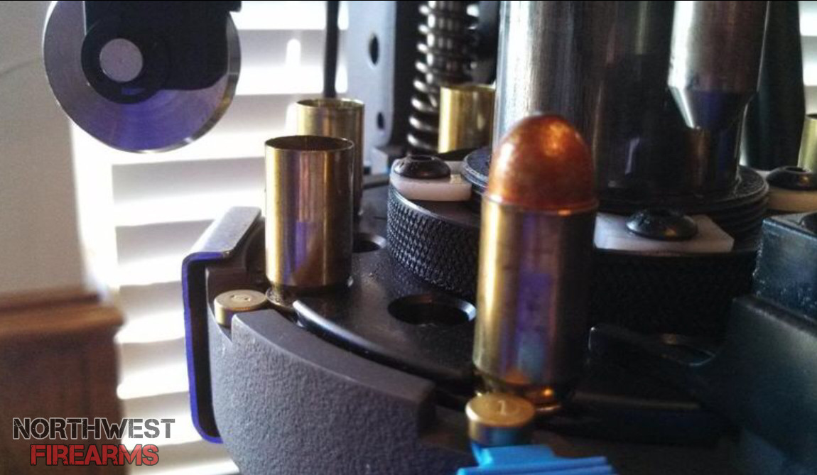

This is how little flare I get away with, using the GSI's, with cast and coated bullets, with no shaving.
ba6b6c8b-b42d-4cb1-9a03-3f4dcf472209-jpeg.2049118
That's a seated bullet without a crimp and the case behind it is charged and ready for seating, the one behind that is waiting on a powder level check.
