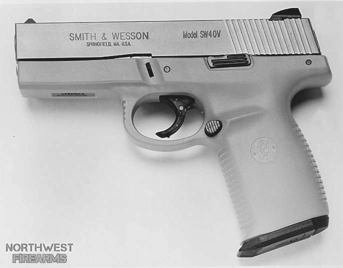

Whats the best/durable method to get the slide darker from stainless to blackish or something like that? SW40V
I plan on dying the frame with Rit Dye,but want to know what you guys have found to work.. read Caswell's stuff doesnt always work on the specific SW Sigma stainless steel?

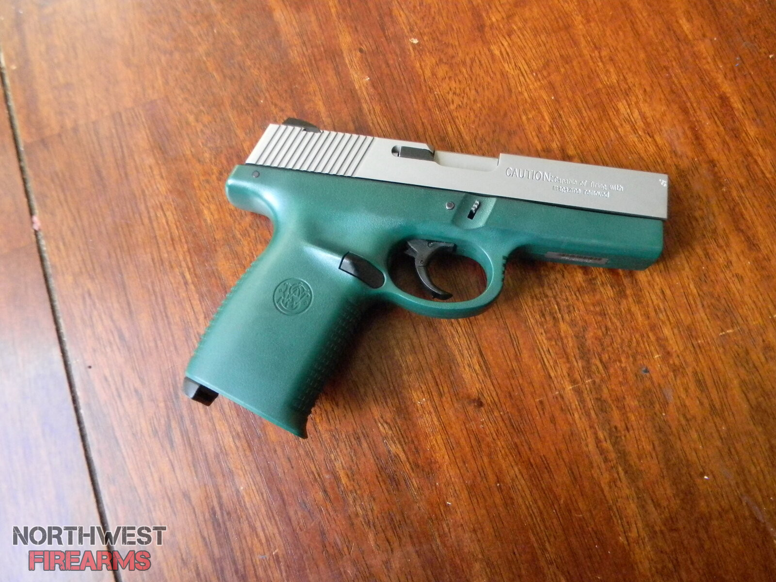

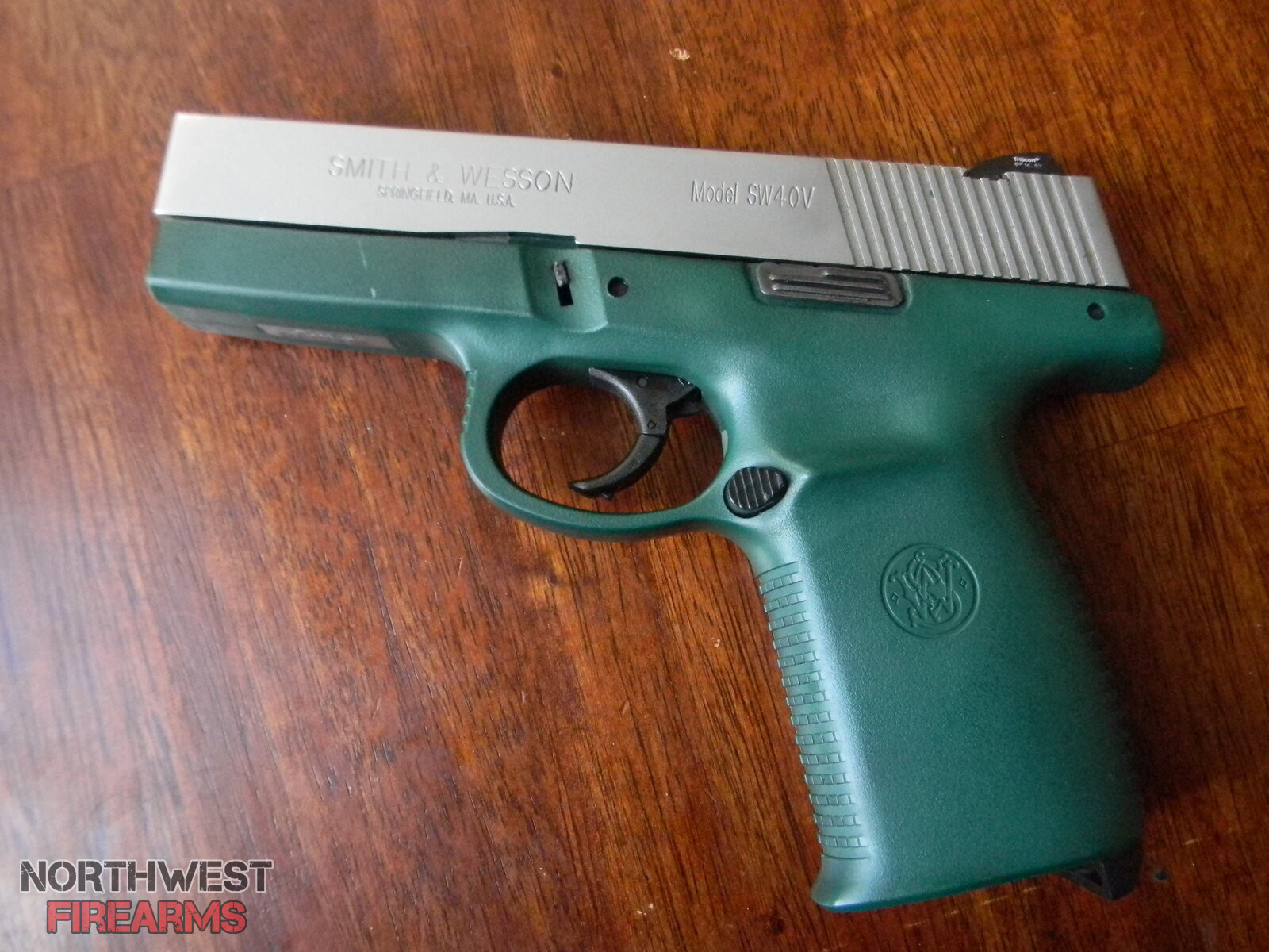

Anyways. I went and Rit-Dyed the frame, without disassembling it. Horrifying, I know! :eek: :s0001:
water, 1 cup of distilled white vinegar, whole bottle of Rit Dye Dark Green, in stainless steel pan, at low heat for 15, 20 minutes.

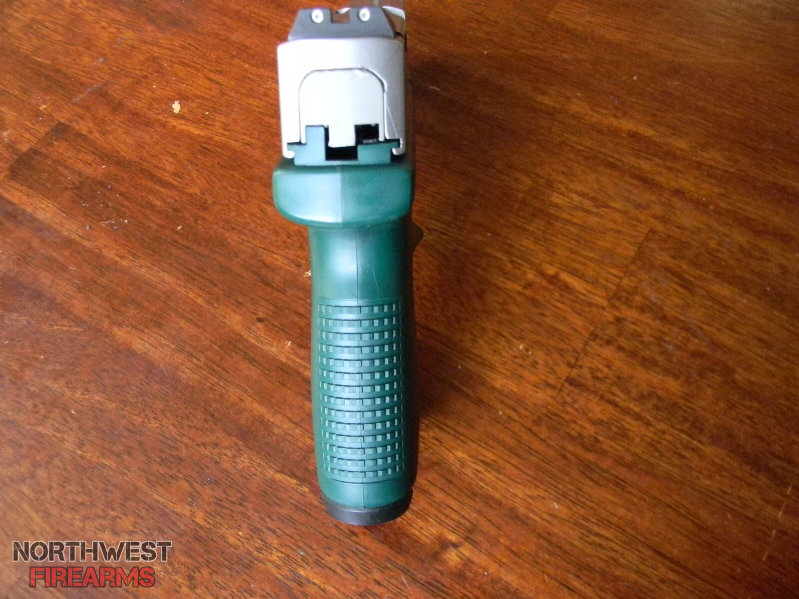

Note, metal parts, some polymers, and black parts will not get dyed. There is apparently a small rounded hexagon shaped insert behind the trigger that did not dye at all. Not sure what it was. No visible mold seams around it, just the centerline mold seams.
Came out looking pretty good, if decidely not quite camo green :s0140: i'll take more pics of it against Woodland and other camos and see which ones its closest to.

Still considering things. I do want to change the sights out but I ain't sure what size they used for the front sight blade?
I do think darkening the stainless slide would help a lot.. or getting it coated somehow.

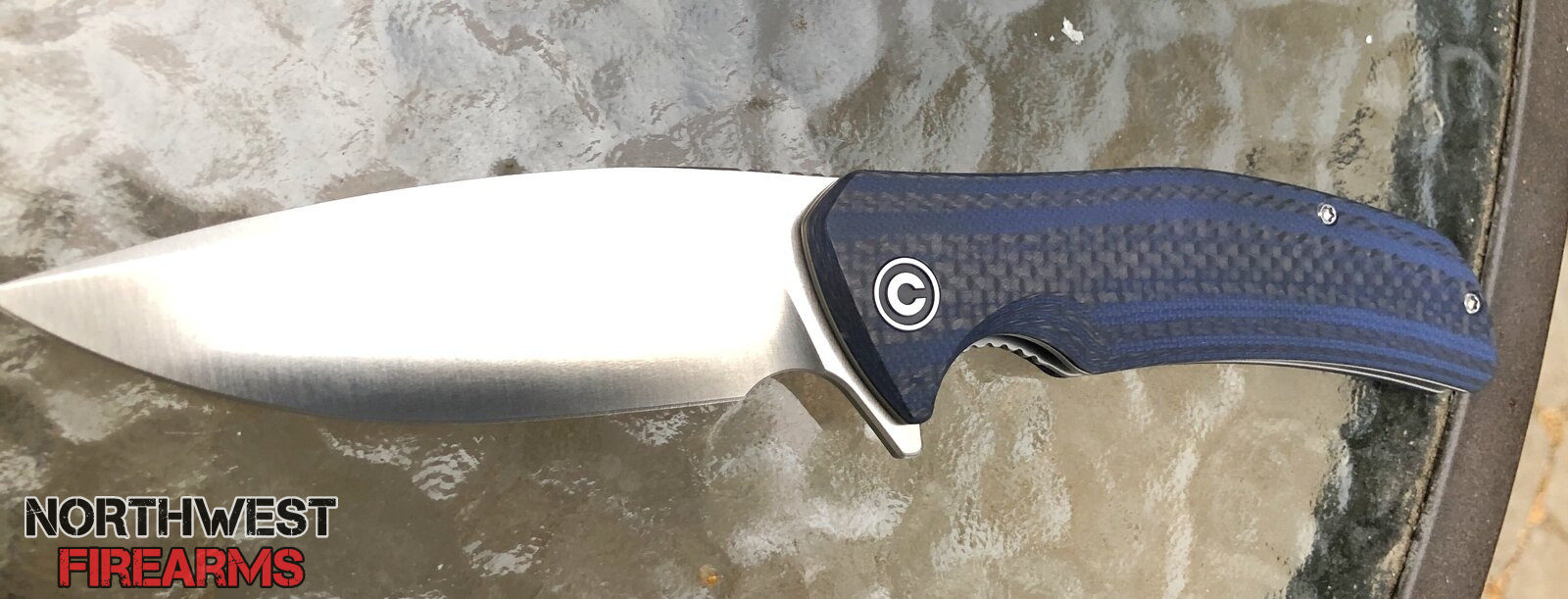

Here is one I did that used to be green (only the g10 absorbed the dye not carbon fiber).

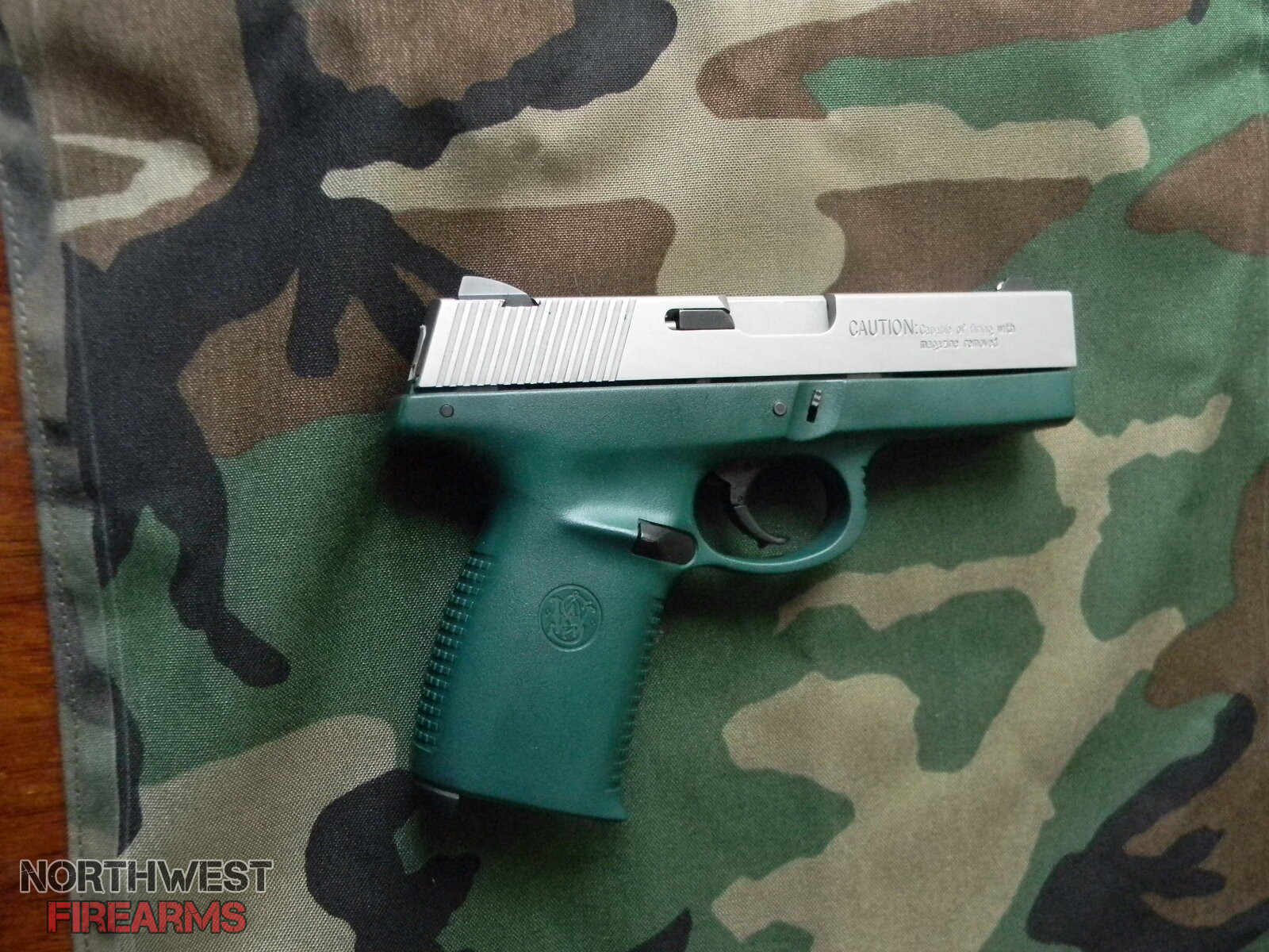

In shade, looks not bad against Woodland 500D

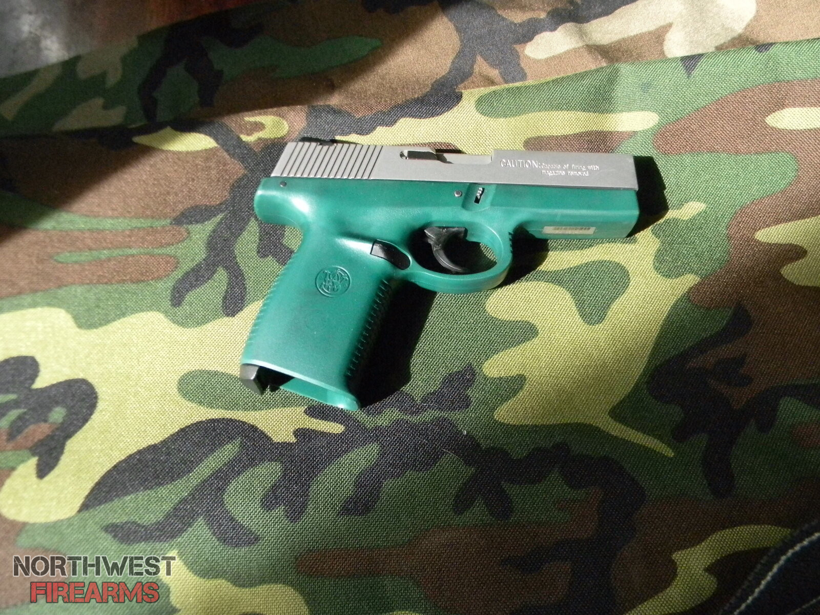

In the sun, BAM its like a light Hunter Green?

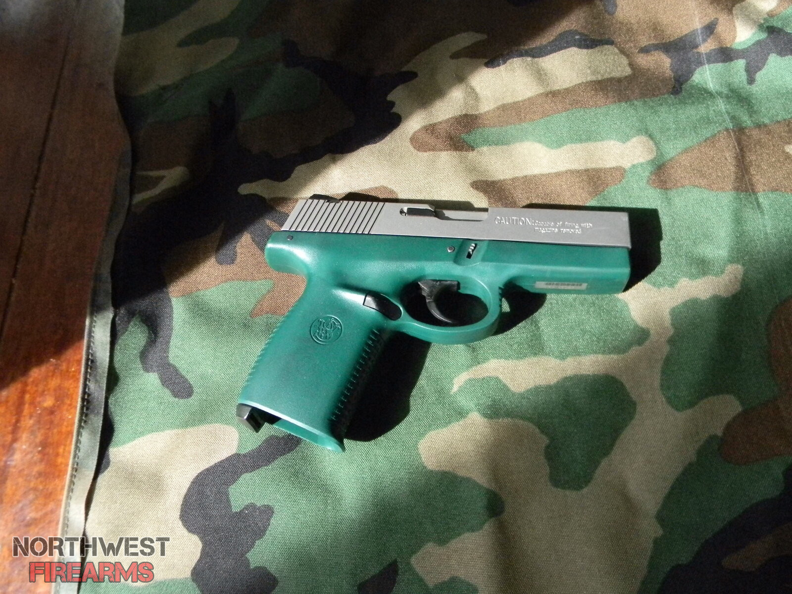

also in Sun, but against 1000D ERDL scaled commercial "woodland" thats closer to Crayola colors.
Definitely interesting results nonetheless.
