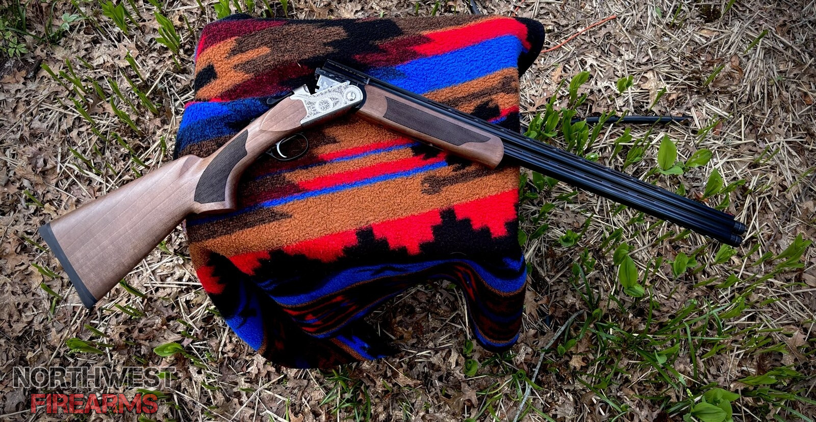

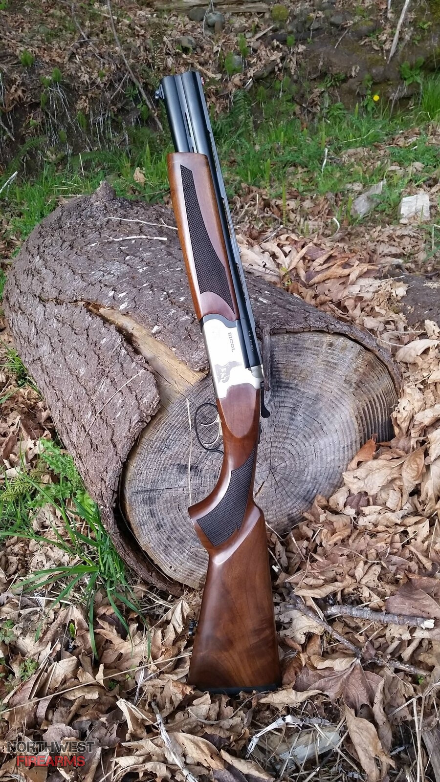

Fe high quality used German SxS $325-$425
2024 pointer 20 gauge $288 shipped
Modifying those if a person wanted makes some helluva interesting guns imo

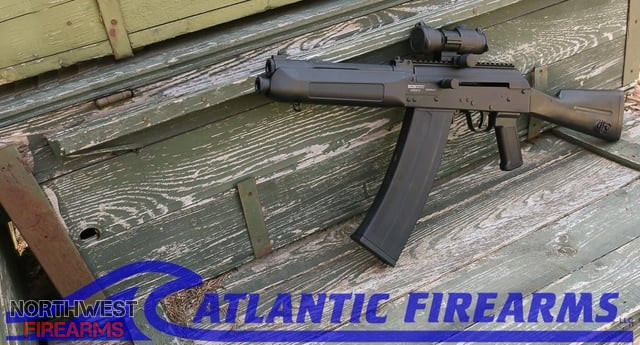

Lynx 12 ultra reliable AK 12 gauge takes drum or stick mags. $300 new. Wood furniture $25 for stock & handguard combined.
