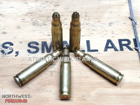

Hello my reloading family, I have some questions on whether or not some 223/5.56 brass I recently got can be converted back to standard 223/5.56, 300BO or just scrap it?
So to start the brass that I have is both 223 & 5.56 with the glaring difference from standard cases is that they are once fired blank rounds. So they have that odd star crimp on the necks. Some of them have smaller shoulders with slightly fatter necks than standard cases.
So can theses be saved and returned to standard case shape(s) or are they destined for the scrap bin?

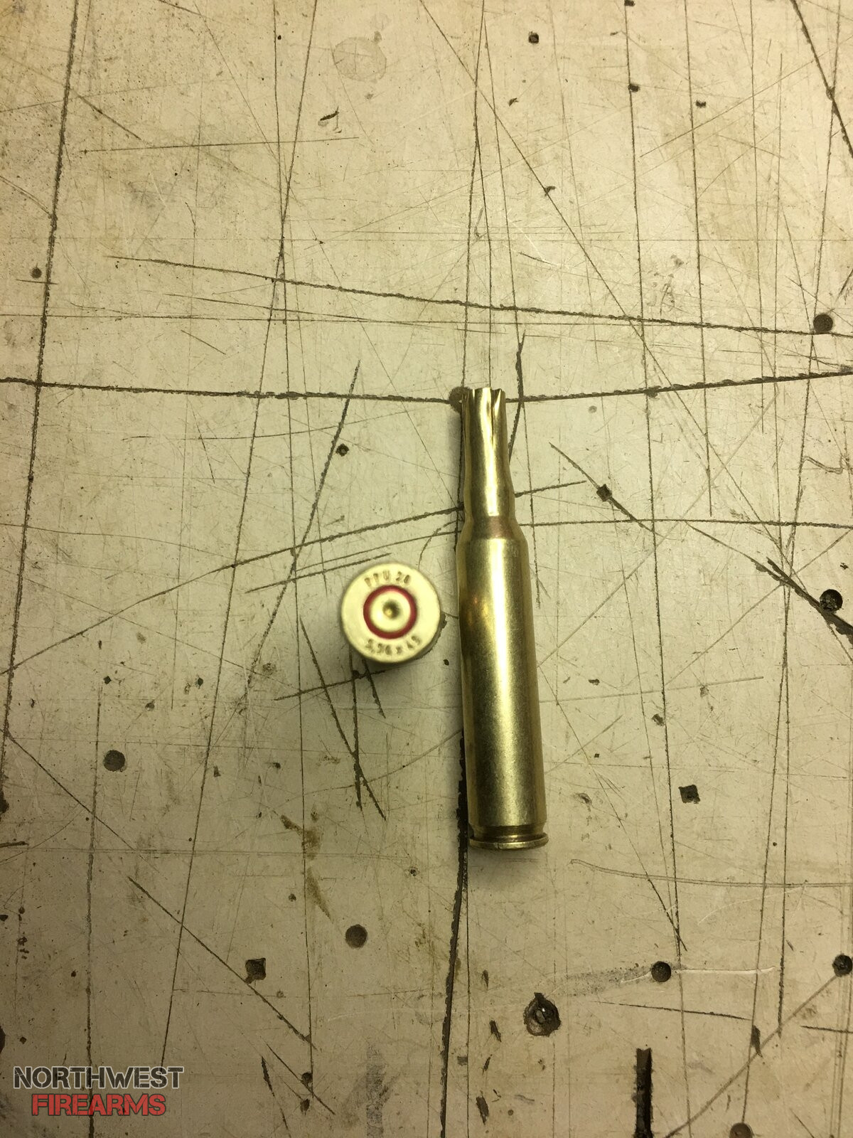

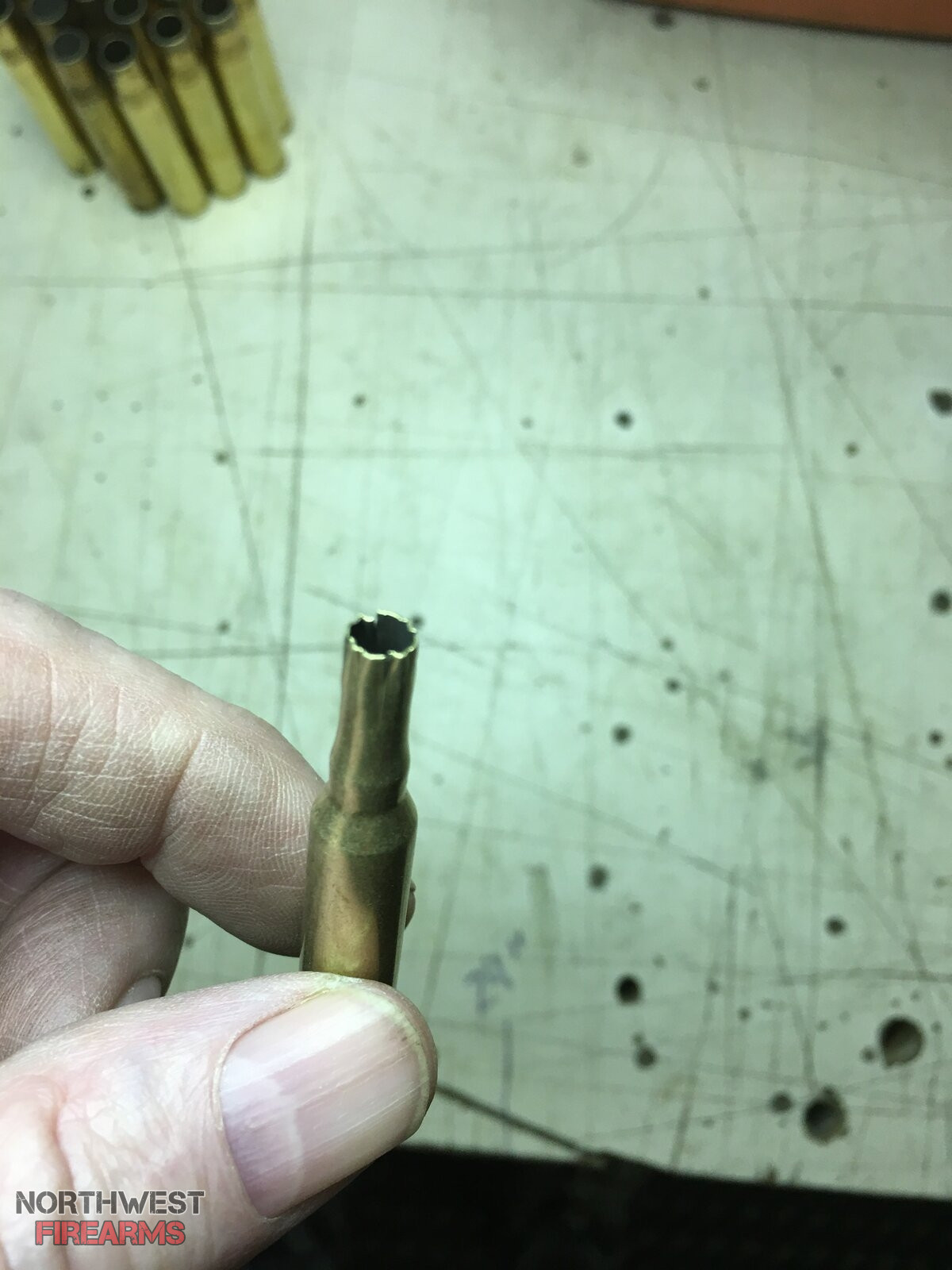

I know i can trim down the one with the red marking but not sure what's up with the cannelure markings.
As for the ones with the green markings I'm not sure about those.

I'm sure they probably could be loaded as blanks again but trying to see if they can be saved and become beautiful loaded rounds, be it 223/5.56 or 300BO. I'm going to add a picture to better show how they currently look.

Yeah the one with the rose crimp seems simple enough as it matchs a standard case but with a longer neck, so I just need to cut off the excess. As for the ones with the green markings, I'm not sure about those yet.

The thing is I'm not sure what's going on with the ones that have the green markings as they don't appear to be the same as the 223 case(rose colored). I think they may have been used as 300BO but I don't use 300BO so I unfortunately don't have anything to compare it to with me to find out.
They do look like .300 AAC blanks. Never new such existed.
Their photo:
I was thinking that to use the green ones in a 223/5.56 you would have to fireform a shoulder along the way.
