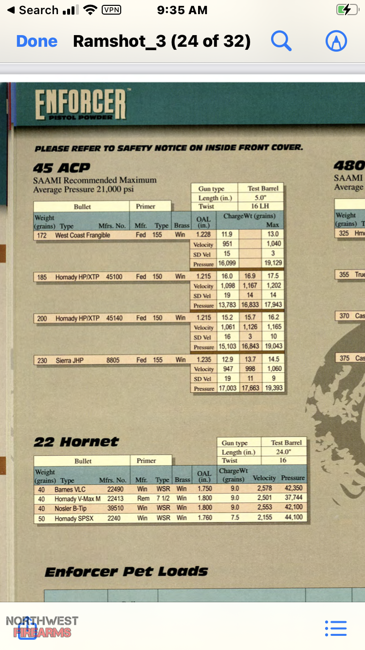

45acp to the extreme without +P pressure? This is not for those sensitive to recoil or prevent the wear and tear. Ramshot Enforcer. While no longer published, there is archived published load data for it if you look hard enough. See attached pic.
