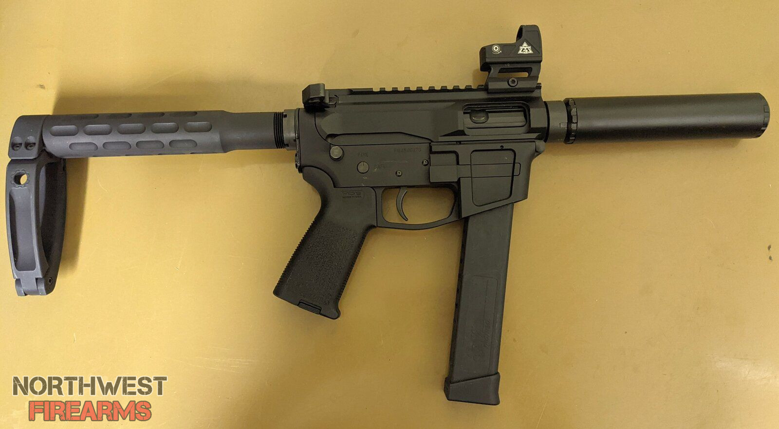

Anyway been doing some home projects. Built a 45 Cal integral silencer for my 45 ACP Bullet Hose ® . Turned out pretty good. 3" ported barrel 6 SS radials in a Ti 6" ASR tube. I was going to go shoot it tomorrow as I was supposed to be off until Thursday but it'll have to wait until the weekend.
I dont use a mill at all. I use a lathe with a mills dividing plate on the rear the with a tool post grinder set up with 1/8" or 1/4" carbide cutters. It allows for full use of the lathe like normal plus any sort of silencer work operation that you'd normally use a mill for. I use an OLD southbend 9a 9"x48" lathe I rebuilt. PXL_20201221_161712785 (1).jpg PXL_20201122_195255877.jpg
When I hear the term bullet hose I think full auto.Why do they call it a bullet hose?
Ive mostly heard that in reference to the M3 grease gun. I named the above gun because I can do whatever I want because I have a superior imagination. My oldest son is named John because he was born in St Johns hospital .
I have no idea if it is possible, but that thing needs a shorter buffer tube.
