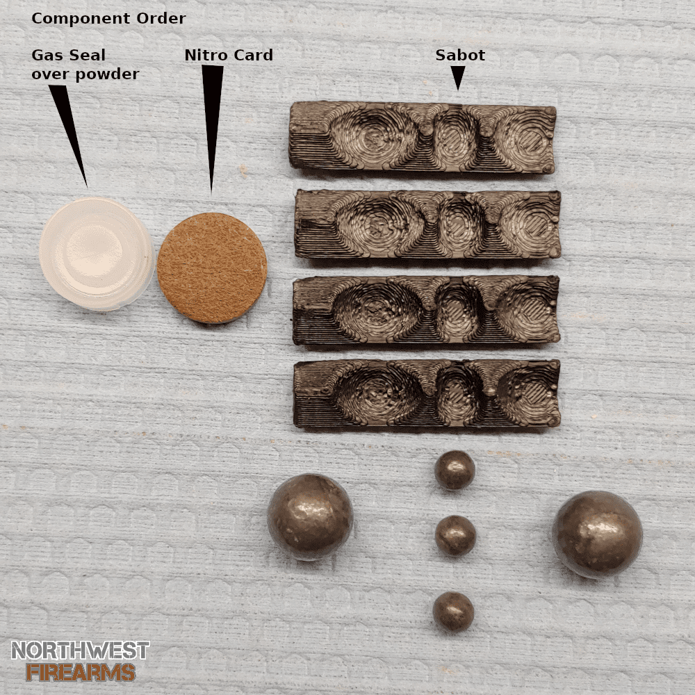

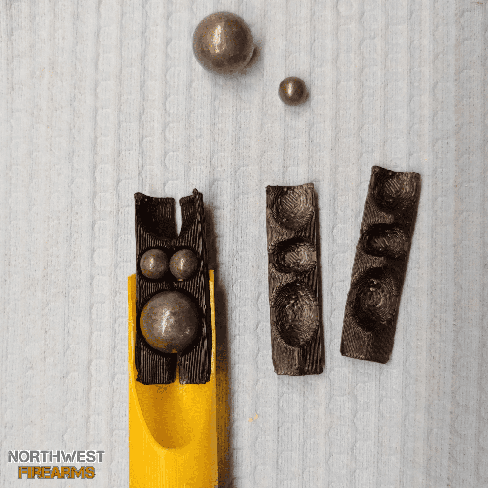

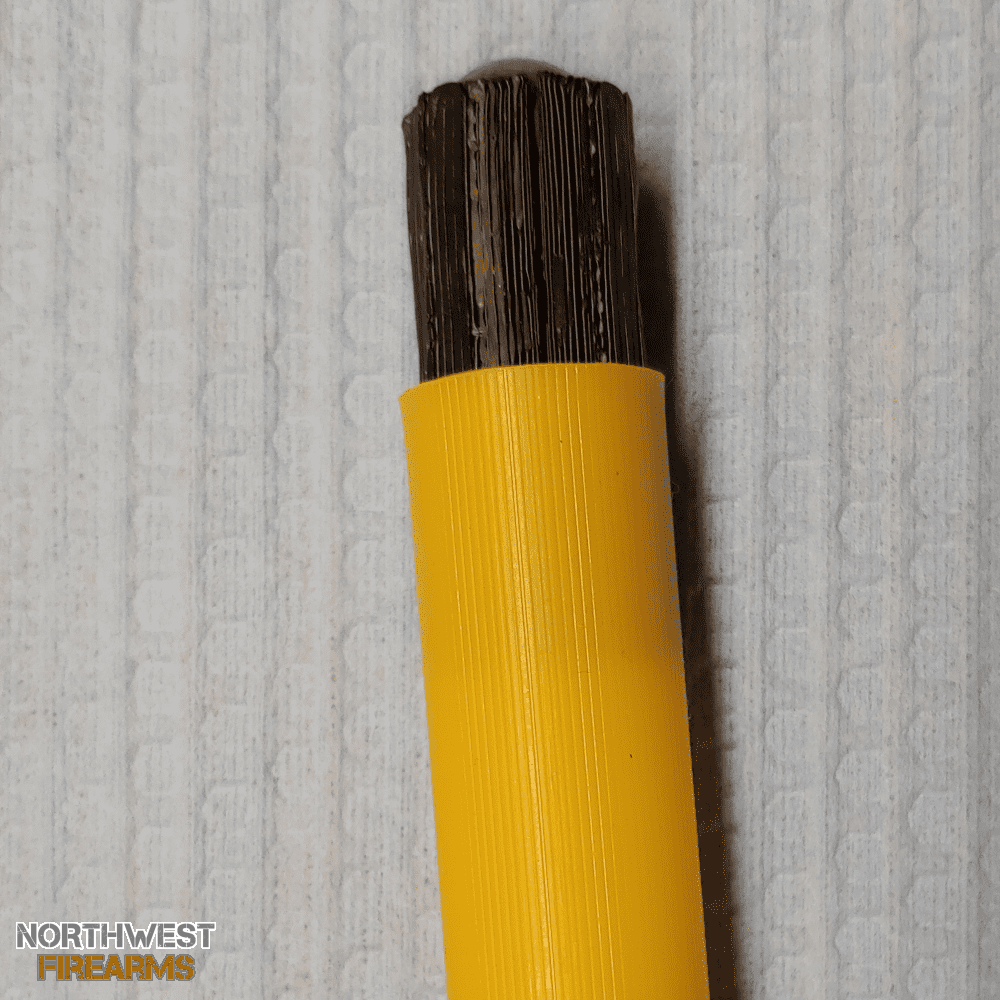

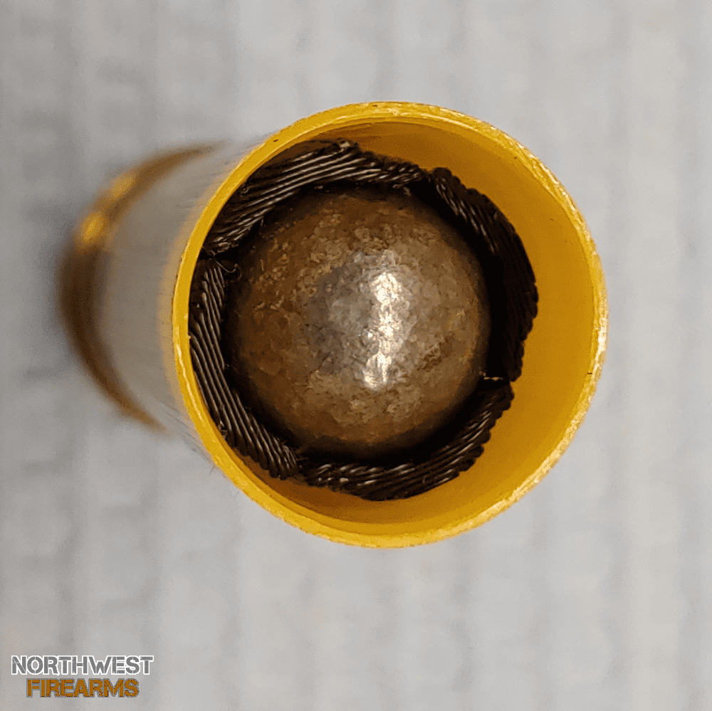

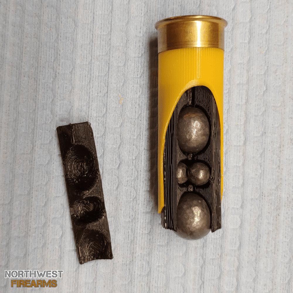

I printed some sabots -- they're ugly because of my old worn out printer, but fit the balls and buck snugly. These sabots hold two round balls and three #4 buckshot. The load weighs in at about 416 gr. in total lead, and about 60 gr. for the sabot. In my usual buckshot load, the one I had pressure tested by Precision Industries, I have about 450 gr. of lead and 25 grains of buffer, so this is pretty close to that in weight.
Enough words, pictures:
bandb-01.png bandb-02.png bandb-03.png bandb-04.png bandb-05.png bandb-06.png

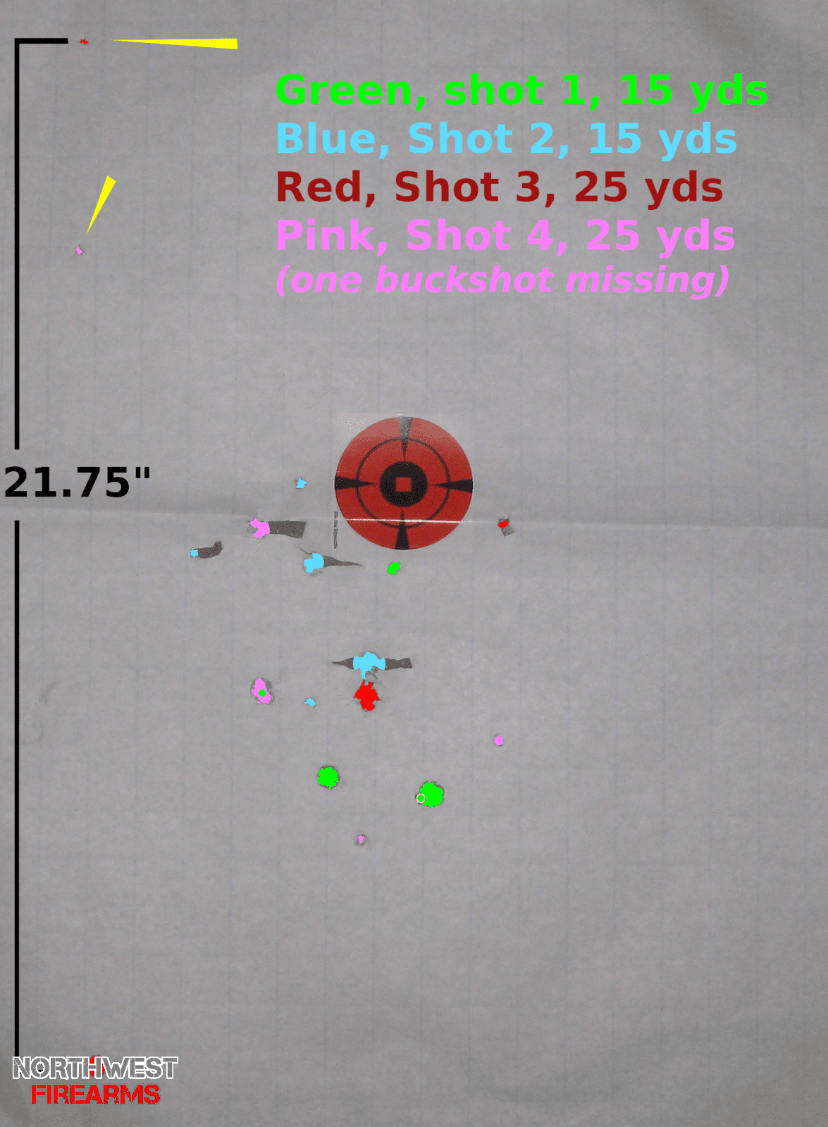

I shot the first two over the chronograph at 15 yds from the target. Only got one good reading: 1280 FPS. This is consistent with my buckshot readings which are usually in the 1240 to 1260 range and likely to be at a safe pressure (*). The second two I shot at 25 yds and merely moved the chronograph out of the way because I was getting to a time crunch.
Here's the target with the shots marked (for the first shot marked in green, note that one of the 4th shot roundballs oblitterated one of the first shot's buckshot marks -- the green dot in the pink hole represents that shot. Also, on of the buckshot hit right next to the round ball in the first shot -- I could clearly see it in the plywood, I've outlined that green buckshot hole in white): EDIT: oops -- it's a red labeled buckshot that is missing, not pink:
(*) when I had my buckshot loads tested, I got 11788 at 25 gr. powder, 11498 psi at 20 gr. of powder and 10576 psi at 19.5 gr. of powder -- I figure my load of 19.8 should be roughly 11,000 psi, which is about 1000 psi less than the max suggested for a 20 gauge, but of course, I'm only guessing and haven't had these buck and balls tested. https://www.randywakeman.com/shotgun_pressures.htm

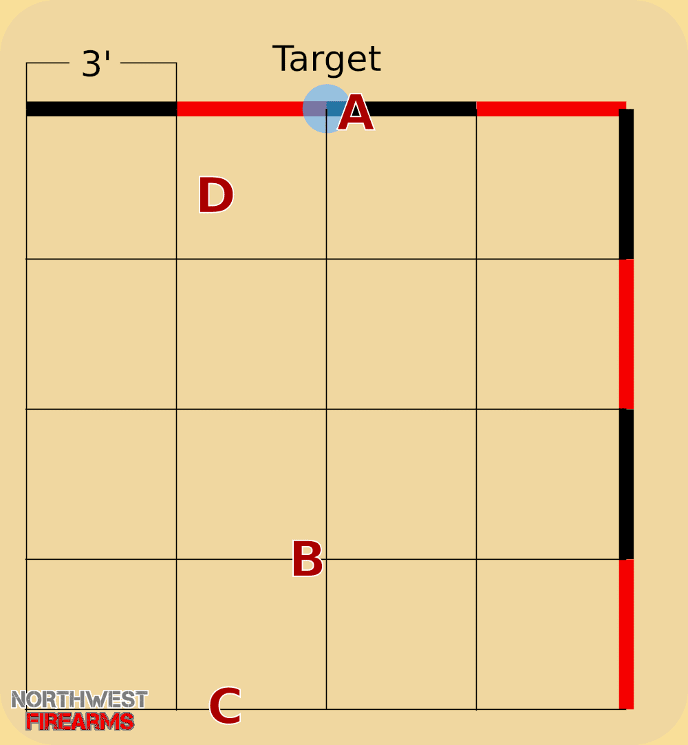

I'm thinking the breakage is related to hitting the flakeboard target stand. I was only 15 yds to the target so while it is possible the sabots broke up in the barrel and light pieces managed to fly only 10 yds, I think it is more likely the sabots broke on impact with the board. Also, petal A was basically just below the bullseye (approximately 9" to the right and a couple inches in front of the plane of the target board) and it was bent with a partial break -- if it came out of the gun that way, I don't think it would have flown so straight. But this is only a guess and it is possible some held together and others broke apart on firing.
