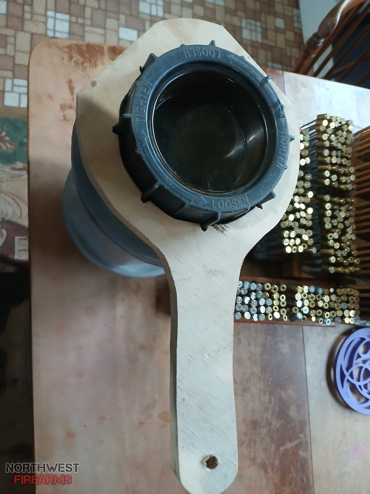

I made a FART WRENCH to loosen the cap on my Frankford Rotory drums.
cool. i use a strap wrench.
I prefer not to torque it down to 700 lb/ft. Plastic only gives so many times before it fatigues.
