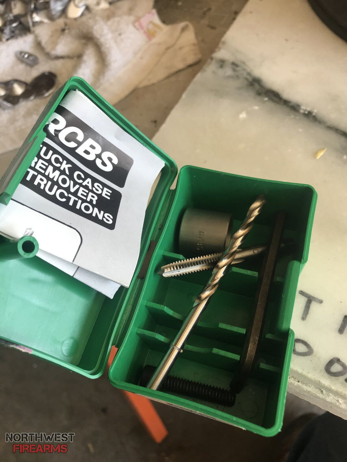

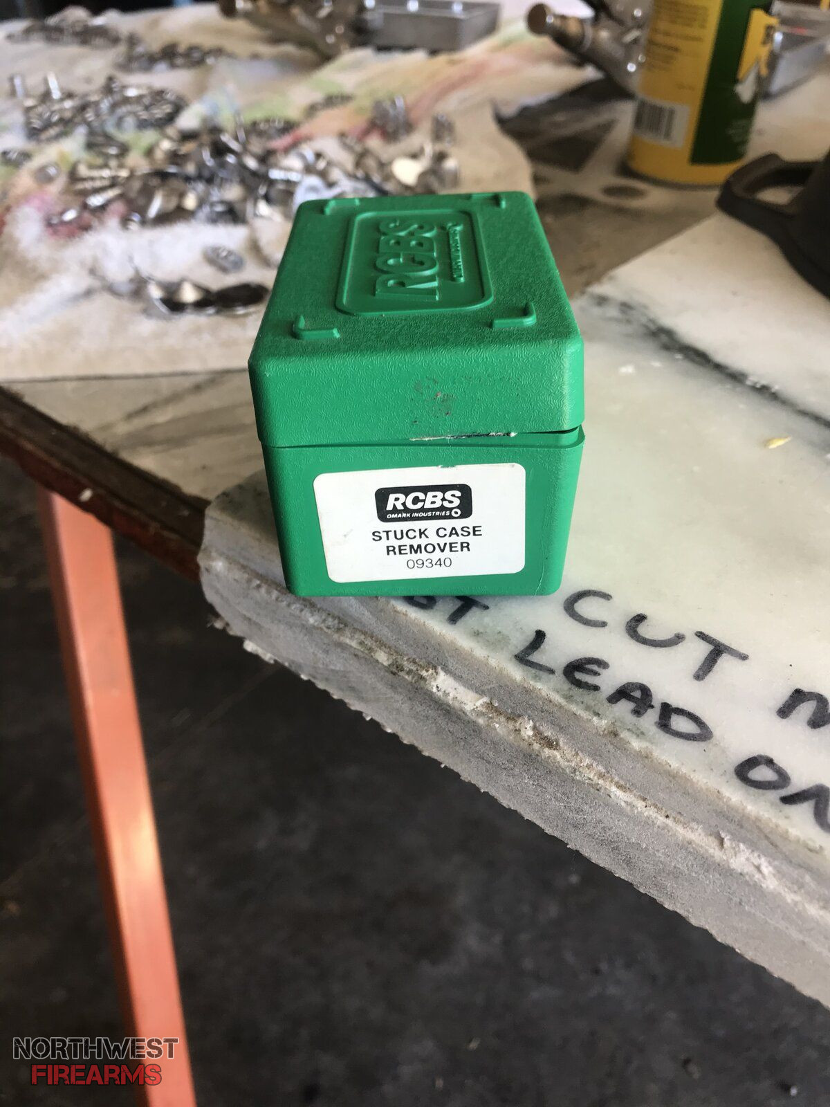

If the case head is still there this works great
AC375477-C4A0-44CB-8CEF-BA2D1B896624.jpeg 5593C3CE-E7B8-4B33-B9F5-033A61D86CEB.jpeg

This is why a stuck case puller is a very wise investment. If you are not patient and careful you can scratch the inside of the die body that will be forever part of your reloading "fingerprint".
I've been in your shoes three times and I then invested in a case puller. It is also a good practice to use a little bit of case lube when sizing any necked cases.
