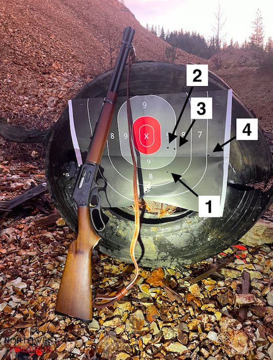

I have a 70s (?) Marlin 30-30 lever action that I recent inherited and have begun getting to know and have quickly have come to the conclusion that it shoots to the right consistently. The sights look very centered on the top of the rifle so I put a red dot on off another rifle to try another way to diagnosis and took it to the quarry. Attached is a photo of what im looking at that I could use some help understanding.
Shot #1 from 25yds, low and to the right - adjusted the optic up a handful of clicks.
Shot #2 from 25 yrds, higher but still to the right - left the optic here and started moving back
Shot #3 from 50 yards, bullet starts drifting further right
Shot #4 from 75 yards, bullet keeps drifting further right
From my understanding, there is no reason the bullet should be drifting further to the right on the x-axis given different shooting distances? I would love to get this rifle reliable but struggling to understand the problem before spending $$$ at a gun smith

Yes, there is a correlation to you moving the shooting position further from the target and the bullet heading further to the right. I highly doubt the barrel is bent, but more likely that the optic and the bore of the barrel aren't pointing in the same direction. If your sight is centered on the target, but the barrel is pointing to the right of that point, up close the bullet will only go a little to the right. But if you stretch that distance, the angle the bullet is travelling compared to the sight stays the same and the bullet continues to the right. Distance doesn't change the angle, it just makes it more obvious.
Go back and shoot up close again. Make your windage correction, or most of what's needed to put the bullet in the red, then move back and try again.

Okay, I think I am over thinking this and what you are saying makes sense as it will travel on the X axis if the angle is off. I'll go mess with it more today, Thanks!

Think about it this way. Stand facing a given direction and point you arm straight ahead. Now turn slightly. If you were to have two people walk in the given directions, they'll continue getting further apart. Same goes for your bullet, it doesn't make as big of a difference at close distances, but after an hour of walking, they'll be a long ways off.
