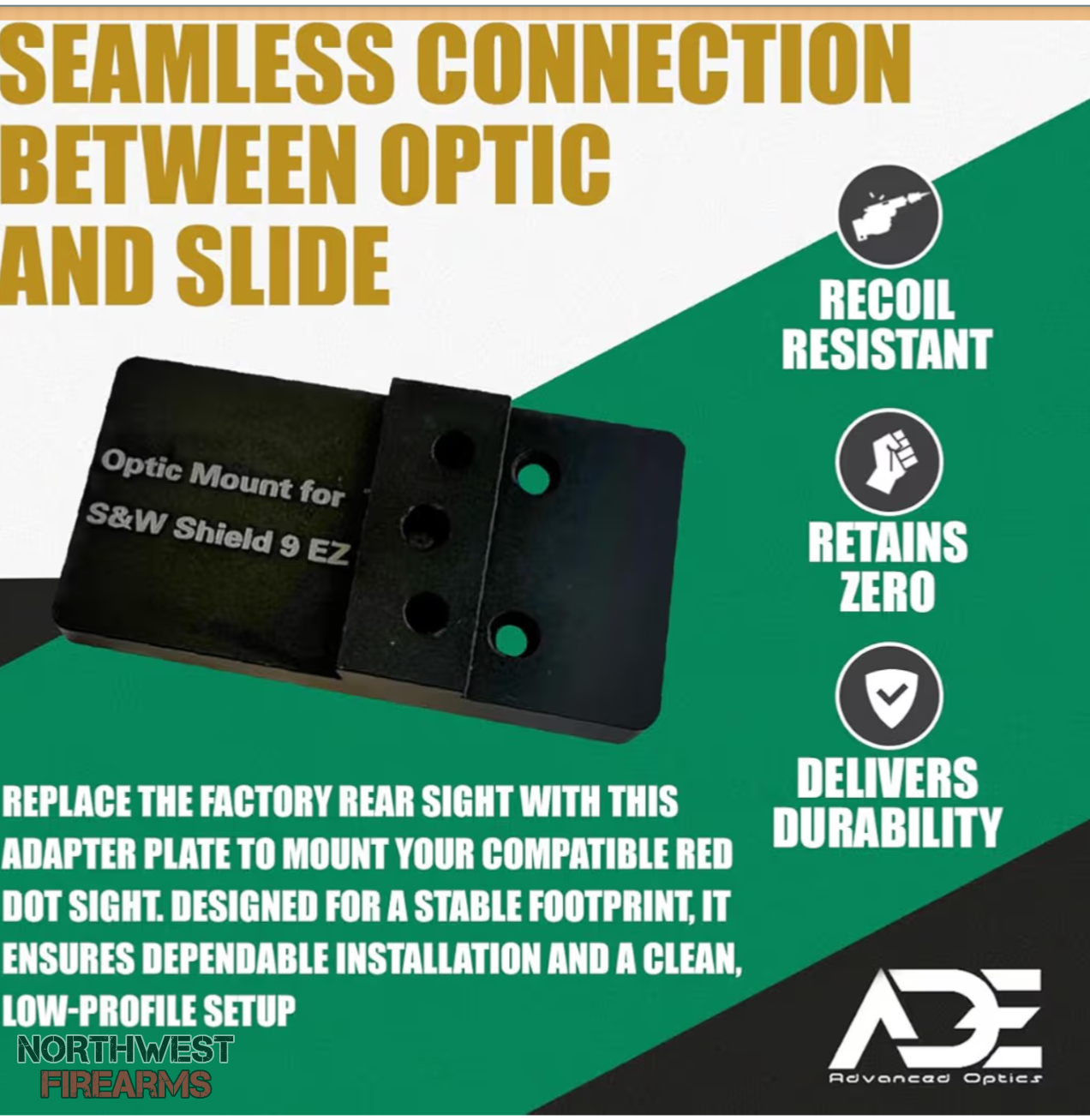

I put a optics plate on my S&W M&P pistol. It mounts in the dovetail where the adjustable sights were, and has one fastner reused that stabilized the adjustable sight from the bottom in a slotted hole to allow adjustment. The plate slides incredibly easy into the dovetail. I loctite the fastner and 4 shots later the plate is so loose that it slides side to side in the adjustment slot. What can I do here, loctite the dovetail? Which loctite? Ideas

I tried using the S&W plastic plate; it got loose every time I took it to the range (has the factory optics milling). Got the C+H Precision Optics Adapter Plate and used blue 243 on the screws. Puppy is solid now.

Not plastic, but I hear you. Not available optics ready, and too thin to mill. Not my pistol, it's my grandson's who suddenly decided he wanted a red dot. I have a safe full of P320s

Purple is low strength - Geissele calls for it on their optic mount, I don't bother with it.
Blue is medium strength - I use for anything with threads I don't want rattling loose except gas block screws.
Red is high strength and high temperature - for gas block screws
Throw the cheesy plate away and have the slide milled
This is the correct answer.

Have a ball peen hammer and flat nosed punch? Peen the wide edge of the dovetail on the plate. Thus, you create an interference fit in the slide's dovetail. May have to use a sight pusher to mount it.
