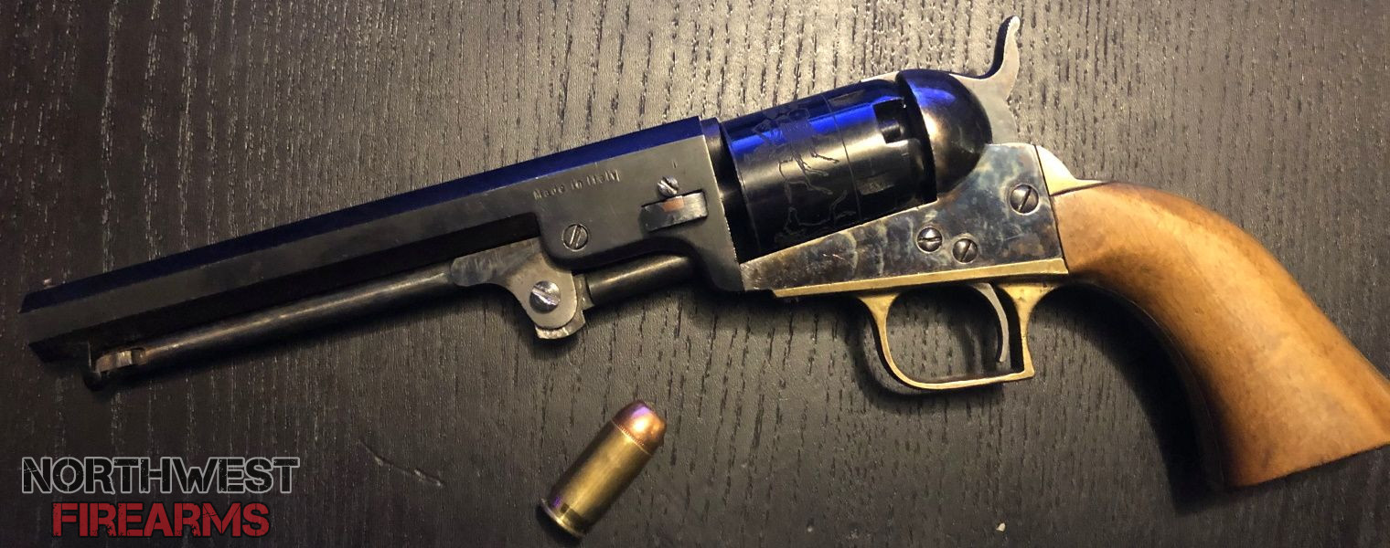

A few weeks back a buddy traded my an Armi San Marco 1848 Pocket (sometimes called a 'Baby Dragoon) .31 for a pair of custom grips. Being me I decided to convert it to fire cartridges. I'd already redone one in .22LR and another in .251 TCR, so I thought I'd do this one in .32 S&W. These guns are small- here's a pic of the gun as I got it, with a .45 ACP cartridge for comparison.
