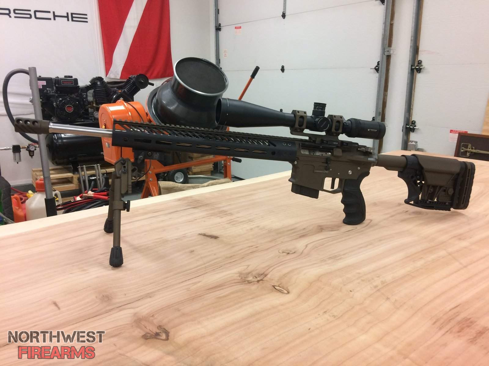

Just finished. My lefty father's 70th birthday present. He shot one of mine a few years ago and since then every time we get to see each other (maybe twice a year) he always brings up that day of shooting. Looking forward to seeing his reaction in a few weeks when he gets here. 6.5 Grendel
Nah. Not possible. You just reversed the photo! You also went to great length to reverse the Porsche sign. You cleverly also reversed the paper bag, cement mixer and gas can half full of gas. And .... you .... you .... you did not reverse the lower receiver mag drop and butt stock stuff?
No. Wait. Is that a real LEFT HAND 6.5 Grendel AR15 rifle? Wow. Wow! More WOW!! I want one. My eye doctor said I have advanced eyeball erosion. How come he asked? I told him 25K+ AR15 and M16 rounds. He nodded. No more, he strongly suggested. I need and want a LH AR 15 rifle.
Thank you. KeepnitReel. Are you happy with the butt stock assembly? I want the older A2 RIFLE stock setup. :)
Fittment is good with the Luth-ar, took awhile to get all the parts needed to complete this build. Big thanks to Jason at Underground Tactical for the barrel and bolt. Billet upper from black rain, billet lower from new frontier. The only main issues now I see is the scope base, ejection cover opens upward on a lefty , hoping to see good ejections with the current setup but might have to go nightforce rings since they use a small lock nut vs quick connect system.
