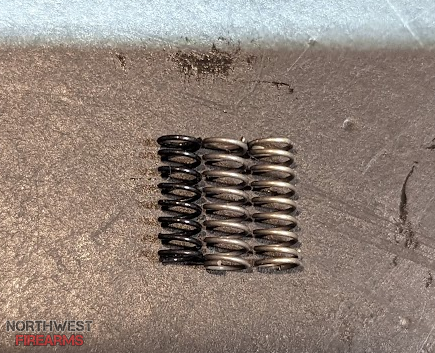

Thanks for the tip. I had seen that thread, but wrote it off because I don't have a BAD lever, but just to be safe I pulled the bolt catch out and the spring was just a tad shorter and smaller than a couple others I had in my spare parts bin (black spring on the left).
I put in a new Geissele Maritime bolt catch I had recently bought from their sale since I had it apart and used one of the spare springs. It feels the same to me, but the proof will be in the putting. I'll get to the range this week and give it a try.

....the spring was just a tad shorter and smaller than a couple others I had in my spare parts bin (black spring on the left).
That would be my first guess. Even if the bolt catch itself is in spec, if the spring pocket is too deep, too tight (restricting free expansion), or the spring or plunger itself is out of spec it may not have the strength to keep the catch forced downward and can allow just enough rise to capture the bolt.
You also want to ensure the catch has free movement within the slot. Especially since it's new there may be some tolerance issues with a rough finish or other than can affect performance. That usually wears in soon enough if you drop a bit of lube and manual manipulation to wear them in a bit. With the finish quality of the geissele that's less likely to be an issue. A bit of fine grit wet dry sandpaper can help smooth out the slot as well. (for future reference).
Since it's happened with every round though, I would guess that's likely not the main culprit and would be suprised if that spring swap doesn't fix you up. If not, I would be checking on free expansion of the spring inside the spring hole or checking depth to make sure it's in spec. Adding a DIY plug of some sort in the bottom of the spring cup might be an option to get it within spec, if needed.

Well, I replaced the bolt release lever and the spring, and that seems to have resolved the issue. I got 60 rounds through it tonight without issue.
