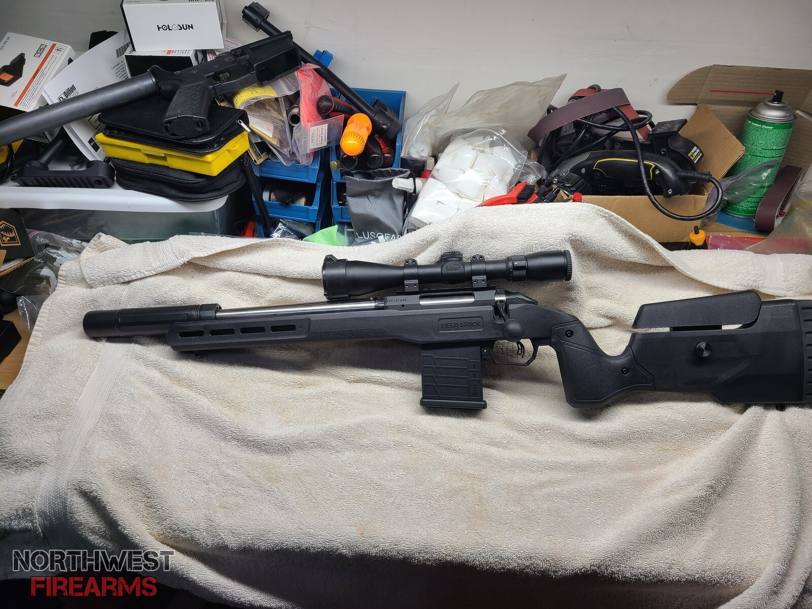

I put together a left hand 300 BLK gen 1, always hated the mags, saw that MDT started making a left handed stock for the Ruger American that used aic mags, bought one on black Friday for $200.00, had to open up the end of the barrel channel a little for the suppressor to fit only running a 10" barrel, better stock and better mags liking the rifle a lot more now.
